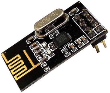

You will learn how to connect two Arduinos using Bluetooth in this instructable. To use Bluetooth, we will use two NRF sensors, one for each Arduino. Two potentiometers are used with the transmitter Arduino to control the two servos on the receiver Arduino.

Connect each Arduino to a Bluetooth module using a breadboard
  1. · CSN - 8
  2. · CE - 9
  3. · MOSI - 11
  4. · MISO - 12
  5. · SCK - 13

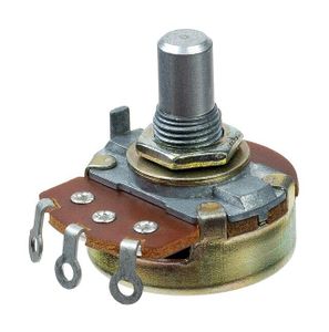

Connect the potentiometers to the transmitter Arduino
Potentiometer 1:
VCC - power on breadboard
Signal - A0
GND - ground on breadboard
Repeat with Potentiometer 2, but put the input in A2

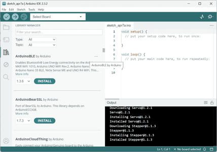

Step 3: Install Libraries
Install needed libraries
You will need to install libraries for the nRF modules to be used. It can be found directly in IDE. Install this library directly from the Arduino IDE Library Manager. Search for “rf24” and install the one by “TMRh20, Avamander”.
