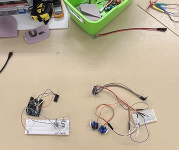

Step 3: Single Servo and Potentiometer
Follow the wiring diagrams below to add on a servo and potentiometer onto the same system as your already wired bluetooth modules. Make sure your pin placements are correct and make sure your servo is attached to your receiver arduino and that your potentiometer is with your transmitter arduino.
  1. Transmitter: Potentiometer Wiring
  1. Receiver: Servo Wiring
This next section of code is to be used to make your potentiometer control your servo via the bluetooth modules. Again, make sure all pins are correctly placed and aligned with the code as well as making sure the receiver and transmitter addresses match.

Step 4: Scaling Number of Potentiometers and Servos
If you want to add more potentiometers to control more servos, follow these wiring diagrams. Just as always be warry of your pin placements as they need to line up with the code.
  1. Receiver: Multiple Servos to Arduino
  1. Transmitter: Multiple Potentiometers to Arduino
This last section of code is to be used when scaling the amount of potentiometers and servos. Since this code uses an array, you can add even more potentiometers and servos if wanted, you just have add in more of the code.
