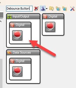

  • Add "Debounce Button" component

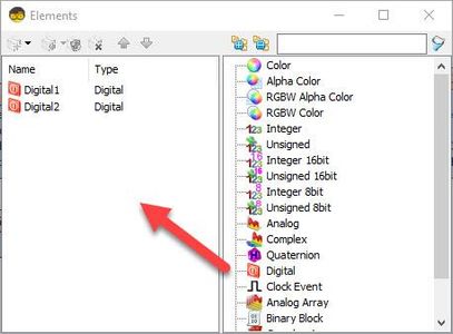

  • Double click on the "MakeStructure1" and in the "Elements" window drag 2X "Digital" to the Left side
  • Close the "Elements" window

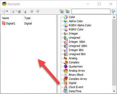

  • Double click on the "SplitStructure1" and in the "Elements" window drag "Digital" to the Left side

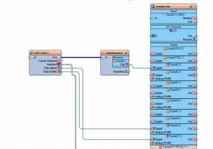

  • Connect "NRF24L011" pin Interface [SPI] To Arduino board pin [SPI]
  • Connect "NRF24L011" pin [Chip Select] To Arduino board digital pin [10]
  • Connect "NRF24L011" pin [Chip Enable] To Arduino board digital pin [9]
  • Connect "NRF24L011" pin [Out] to "SplitStructure1" pin [In]
  • Connect "SplitStructure1" > "Digital1" pin [Out] to Arduino digital pin [2]

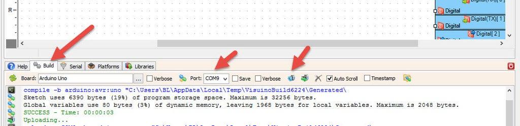

Step 7: Generate, Compile, and Upload the Arduino Code
In Visuino, at the bottom click on the "Build" Tab, make sure the correct port is selected, then click on the "Compile/Build and Upload" button.
