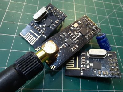

I am working on a 2.4ghz radio receiver module, NRF24L01 is the best and cheapest module which supports a long range along with high data speed in tasks like remote sensing. These modules are very easily available to anyone and very difficult to troubleshoot. Today we will discuss the problems with these modules along with basic circuit of transmitter and receiver.

NRF14L01 And Features:
  • Worldwide 2.4GHz ISM band operation
  • Up to 2Mbps on air data rate
  • Ultra-low power operation
  • 11.3mA TX at 0dBm output power
  • 12.3mA RX at 2Mbps air data rate
  • 900nA in power down
  • 22µA in standby
  • 1.9 to 3.6V supply range
  • ±60ppm 16MHz crystal

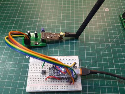

I have two modules, one with long antenna and internal amplifier and other one is simple. As for test purpose, we will use a simple blink code to make our project working. The Led will only blink at the receiver end if triggered from transmitter.

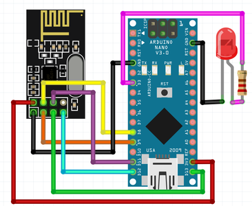

Receiver and transmitter wiring is depended on Arduino Digital pins mentioned in code. Chip enable and chip not enable connections are goes to digital pins 9 and 8 respectively. Chip not enable signal is a logic low signal and always remains at high except when you are sending the device an SPI command or getting data on the SPI bus from the chip. SPI communication is very basic, just connect the MOSI to D11, MISO to D12 and SCK to D13. We are not using any interrupt to do this so no need of IRQ pin here.
In the transmitter section the D3 pin is used as input, which is made input pullup and activated when connected to ground. So, a tactile button is placed to make it more responsive.

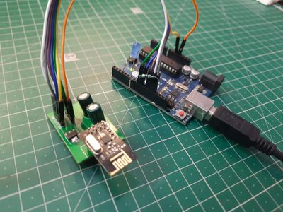

In the receiver section the D3 is defined as output, a LED is connected to the pin with 220ohms resistor. Which remains high if the receiver doesn’t find any transmitter and after that it can be controlled using the tactile button.
These NRF4L01 modules work on 3.3volts and need a maximum of 30Ma. Here I am using a pcb adaptor the files can be downloaded from here. Have a look on troubleshooting section at the end of this article, which will give you more brief designing tips.

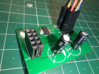

I made a shield to reduce the overall noise, I added two electrolytic capacitors for power filtering and 2 ceramic filters for low frequency blocking. To make the module breadboard friendly the Pin headers are mounted in one direction.

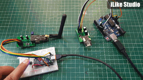

I uploaded a blink program, so the led will only blink when a signal from transmitter is given to receiver. The output is changed as per tactile button input. You can also use different power modes to change the speed of data transmitted. All the function of NRF24L01 is mentioned in the datasheet.

Keep the SPI connection tracks as smaller as possible, which helps to reduce the noise.
Keep the MISO and MOSI tracks away from +5v, 3.3v power lines.
Add filtering capacitor on input and output of the voltage regulator, which will help to filter the power line ripple noises.
