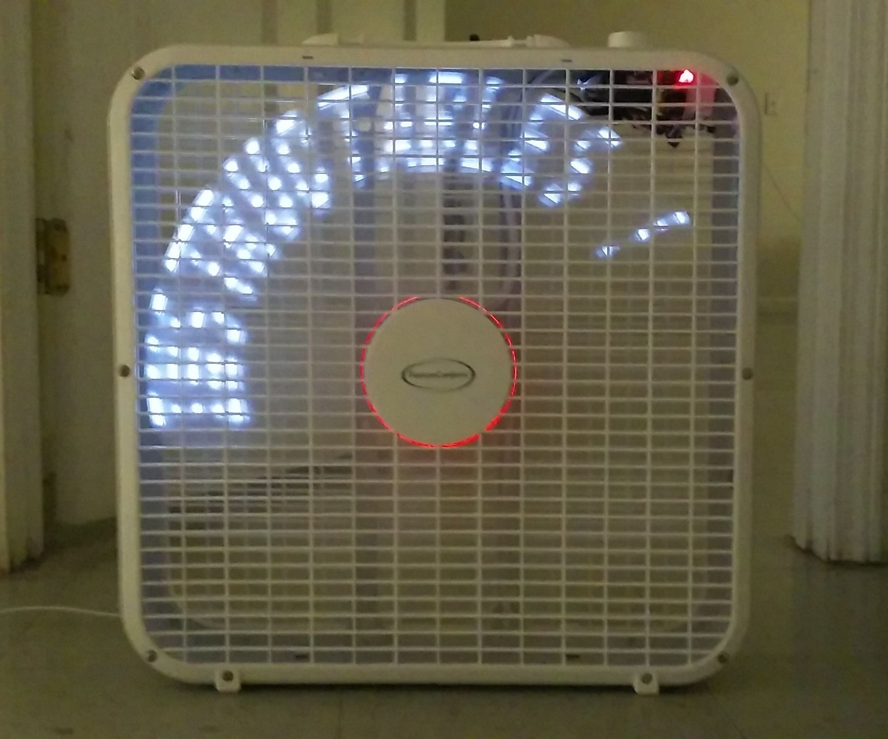

My "Title Shot" shows a breadboard without the FTDI, but with a voltage regulator on the end of the board. Most FTDIs can power the Blue Pill for this project. Also, I created a number of LEDs with a cardboard backing and 220 Ohm resistors pre-soldered for quick prototyping. This is why you don't see the resistor on the board.
