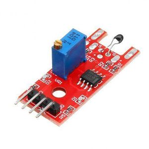

Step 1: FUNCTIONING
This module uses an NTC thermistor to measure temperature. The output is normally input to an analog port on a uC where the temperature can be read and calculated. Thermistors are essentially resistors whose resistance value changes with changes in temperature. NTC stands for "negative temperature coefficient", which means that the resistance of the sensor will decrease as the temperature increases. The thermistor is in series with a 10K resistor creating a voltage divider. As the thermistor heats up, the resistance decreases and the analog output increases towards Vcc. The sensor is capable of reading temperature in the range of -55 to +125°C with an accuracy of +/- 0.5°C.

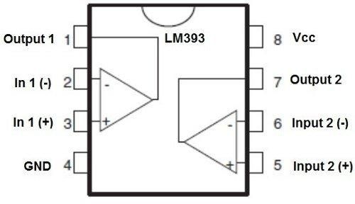

LM393 - Dual SMD Voltage Comparator.
It is a dual integrated circuit designed to be used as a precision voltage comparator, with single or dual source supply capability.
Technical characteristics:
• Supply voltage: Simple from 2V to 36V, Double from ± 1V to ±18V.
 • Output voltage: 36 V.
 • Response time: 1.3 µsec.
 • Output voltage compatible with DTL, ECL, TTL, MOS and CMOS logic levels.
 • Operating temperature: 0°C ~ 70°C.
