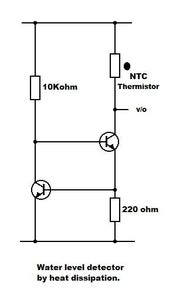

2 x Small signal Transistor; any NPN with a gain of 100 or more.
1 x 10K ohm Resistor
1 x 220 ohm Resistor
1 x 500 ohm variable Resistor (TrimPot) - Optional
1 x NTC Thermistor
1 x circuit mounting board

Using a NTC (Negative temperature coefficient) Thermistor with self heating could cause it to over-heat if not controlled i.e it gets a little hotter; the resistance goes down and current increases making it hotter and hotter until it fails.
I suggest using a constant current source due to W=I^2 x R and that will prevent thermal runaway: If the Thermistor gets a little hotter then because W=V^2/R as the resistance decreases it becomes self-regulating.
Step 3: Practical Circuit.
The constant current source diagram shown is set at 4mA by the 220 ohm resistor and gave me a voltage change of 11.6 volts from a 22v supply voltage (i.e about half the supply voltage). A variable resistor could be used to find a suitable current for any particular thermistor but I recommend a resistor "chain" that can have each element short-circuited to find the best value. A "chain" could be a combination of 56 and 100 ohm etc. but be sure to start at the highest total resistance.
The difference change in voltage across the device is relatively large so a simple transistor switch or comparator circuit could drive a relay to control water level.
