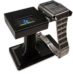

I used this code from https://vmod.wordpress.com/solo-dcf77-esp32-transmitter/ and https://vmod.wordpress.com/solo-dcf77-esp32-transmitter/

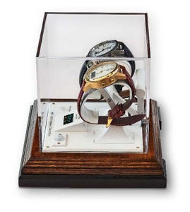

Pic 1 original compact project designed to synch a single watch.
Pic 2 The watch stand is available here https://www.printables.com/model/419380-timeless-organization-the-minimalist-3d-printed-wa
I used two of these with one printed reversed which fit into my 3D printed base.

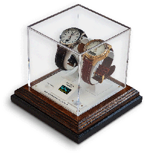

My design holds up to 2 watches and has a movable DCF77 transmitter antenna to allow the antenna to be located correctly for various different watches/clocks.
The code has been changed slightly to show the time code segment being transmitted to the watch.

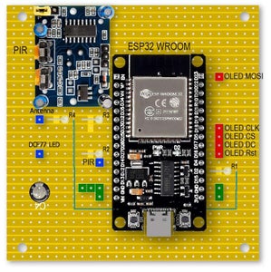

I have used Vero Board rather than a PCB and a WROOM 32 module.
An LED displays the DCF77 pulses and a PIR turns off the display when no one is around.
The watch holders are mounted in a 3D printed base that also houses the OLED display, DCF77 LED and PIR.

Pic 1 Dust cover removed showing the parts.
Pic 2 Side view showing aerial arm details.

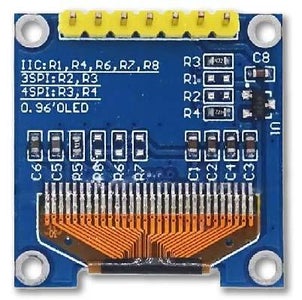

Pic 1 The display is a 0.96 Inch Yellow Blue OLED Display 12864 SPI IIC and can be found on Amazon here .
Spec
Display area: 21.744 x 10.864mm 128 x 64 pixels
Physical size: 27.3 x 27.8mm
Interface type: Default 4-wire SPI
Switchable rear resistor to use 3-wire SPI, IIC interfaces
Pic 2 rear view of OLED showing resistor options for I2C and SPI.

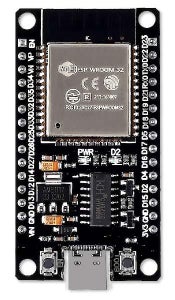

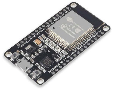

Step 6: Electronic Parts & Modules ESP32 WROOM32S 30Pin

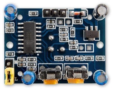

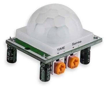

HC-SR501 PIR Motion Sensor Module
Pic 1 Adjustment
• Adjust the distance potentiometer clockwise rotation, increased sensing distance (about 7 meters).
• Adjust the delay potentiometer clockwise rotation sensor the delay lengthened (300S) or anti clockwise to shorten the induction
delay (5S).

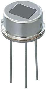

Pic 2 Rear of the PIR Module showing sensor pins soldered to the PCB.
Pic 3 The SR501 sensor is de-soldered and mounted on the base.
Pic 4 SR501 PIR Sensor

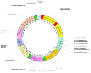

Pic 1 The chart below shows the makeup of the DCF77 time code transmitted at 1 pulse per second over 60 seconds

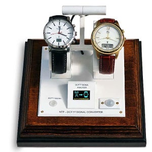

Insert your watches onto the holders and move the transmitter aerial close to the watch faces.
If you are synchronising a clock position the clock behind the clock synchroniser and move the transmitter aerial near the clock.
You will need to find the best location for the transmitter aerial as it will vary for each clock/watch being synchronised but some come with signal strength indicators which make setting up much easier.

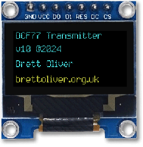

Power up the clock synchroniser and you should see the OLED display cycle through the startup cycle.
Once connected to the NTP server the final screen shows the code being sent through the aerial and also the local time and date.
I have modified the original code to show information on which data is being transmitted second by second.
The animation below shows a summary of what is displayed on the OLED.
When DCF77 data is being transmitted the DCF77 Signal LED will flash accordingly.

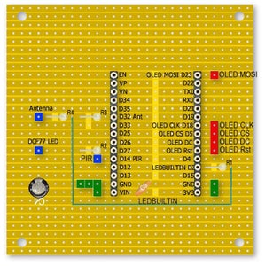

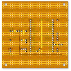

Step 12: Veroboard Layouts
Step 13: Aerial Construction

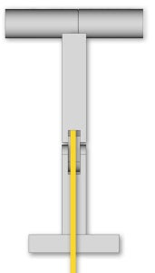

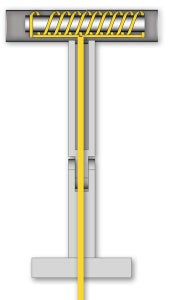

Pic 1 completed aerial with aerial wire going through the AerialArm into the left & right Aerial Tubes.
Inside the aerial tubes the wire is wrapped around a small ferrite rod.
I just experimented with different wire/ferrite rods until I got a few centimeter range out of the aerial.
I used a DIY DCF77 signal monitor (design to follow brief details in step 14 ) to check my aerial did not have too much range.
Pic 2 Details on the cut away diagram.

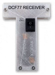

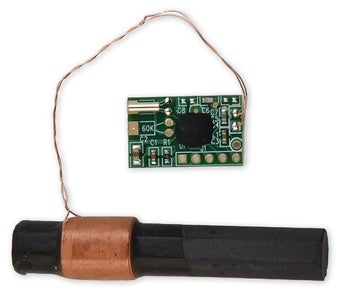

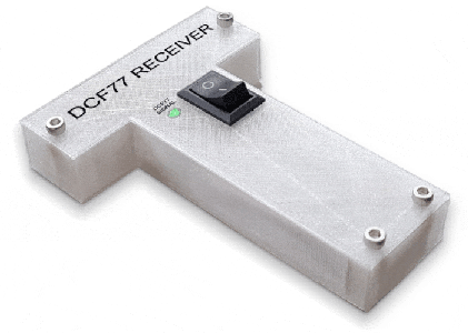

Step 14: DCF77 Monitor
This simple device is made from a DCF77 Module Pic 3, a switch, LED and 2 AAA batteries housed in a 3D printed case.
Pic 1&2 The Module picks up the DCF77 signal from germany but can also be used to check the DCF77 signal range from your watch synchroniser.

AerialArm 1 off
Fixed to the AerialBase with an M2 nut and bolt to allow adjustment of the aerial.
Curved at the top to allow it to be glued to the left & right aerial tubes.
Slotted for the aerial cable.

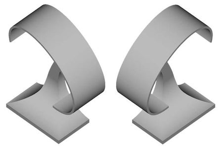

WatchStand 2 off (one printed mirrored)
As only the STL file is available for download one will need to be printed mirrored in CURA.

Fixed to the wooden base with M2 screws the stand rear provides fixings for the StandRearCover.
The StandRearCover has 4 M2 brass inserts fitted to the lugs on the inner part of the cover.
A cable exit slot is cut into the rear.
StandRearCover 1 off
The StandRearCover is bolted to the StandRear with 4 off M2 bolts into the brass inserts fitted to the StandRear.
The four raised areas are drilled for M2 self tappers from the Vero board mounts.
A cable exit slot is cut into the rear to align with the slot on the StandRear.
