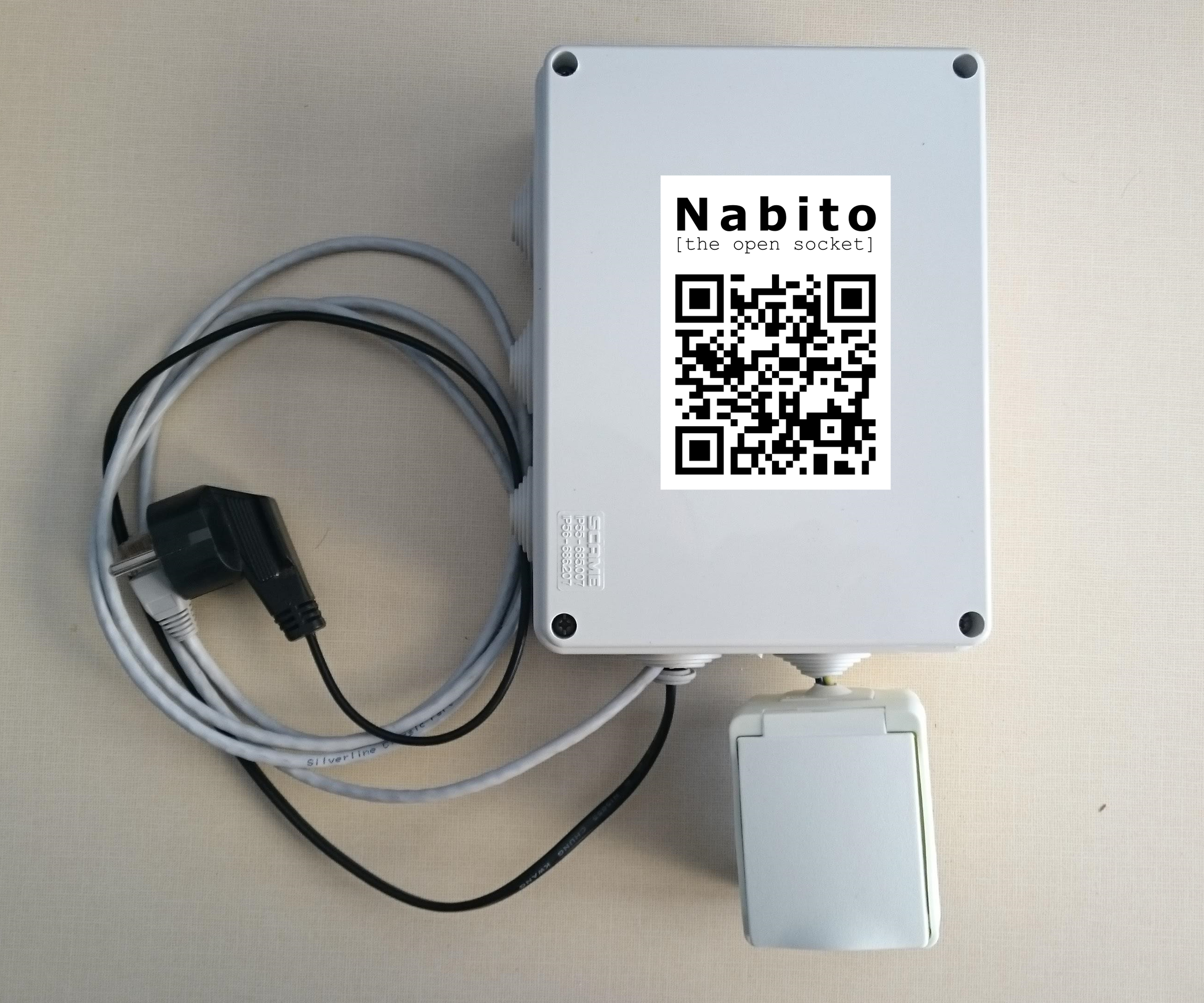

Nabito - the open socket is an IoT smart meter with electricity metering, on/off high amperage switching, NFC sensor, user authorization, billing capabilities and user management.
The project consists of two parts: 1. control box (IoT device) 2. web app frontend/backend, both completely open-source.
1. The control box consists of easy-to-get-online parts and is designed to be an intelligent and yet inexpensive electric socket solution for public and private parking lots for slow charging of electric vehicles. It runs on Raspberry Pi Zero W and Arduino Nano.
2. The web app runs on Ruby on Rails and is available as open source on Github: https://github.com/sysdist/nabito-server The connection between the box and the web app is done through MQTT protocol.
The aim of the project is to develop an open source charging network that anyone could adopt and implement or extend.
It runs on Raspberry Pi Zero W single-board computer (SCB). The total cost of the control box is around €60.
Nabito - the open socket is currently designed for charging on ordinary sockets, in continental Europe it's 230V and 10 -13A, i.e. cca. 2.9kW continuous. But the concept applies to any socket, Euro, US or UK or any other, future versions of the project will cover also 2 and 3 phase installations.
