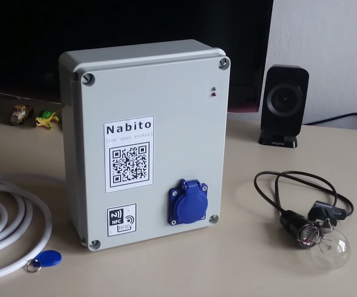

What is it?
Nabito - the open socket is essentially a smart electricity meter with electricity metering, user authorization, billing capabilities and user management. Currently it's in a very early stage but some core functionalities are already in place.
The control box consists of easy-to-get-online parts and is designed to be an intelligent and yet inexpensive electric socket solution for public and private parking lots for slow charging of electric vehicles. It runs on OrangePi One single-board computer (SCB).
The total cost of this solution is around €50 ($60).
Nabito - the open socket is currently designed for charging on ordinary sockets, in continental Europe it's 230V and 16A, i.e. cca. 3.3kW continuous, this is roughly equivalent or slightly higher than US level 1 charging.

DISCLAIMER: The following build guide is rather crude at the moment (missing wiring diagrams, missing some assembly steps, etc.), I wanted to get it out there as soon as possible, will work on improving it if I see the project is meaningful and has traction. I thought this little control box will be easy to document, but to my surprise there are many small steps that I have taken when building this, so please, if this build guide does not cover everything you need to know or if you have any questions, send me a mail. Thanks for understanding.

Step 6: Wiring: Mains Cables
Wire the mains cables like in the first picture.
The black cable denotes the line, the yellow/green denotes neutral.
Yes, I know, the ground is not present in the box and it's a safety issue, in the next versions of Nabito, the control box will be properly grounded, I promise.

Step 9: Wiring Everything Together
  1. Clamp the CT sensor on the mains line going out of the mains relay
  2. Connect the LAN cable and power source for OrangePi.
  3. Screw in the junction box lid
  4. And you're done wiring/assembling!
