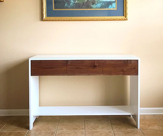

This shelf was built to compliment the Nakashima inspired desk that I made. You can check that build out here: https://www.youtube.com/watch?v=RkR0oYjmknM. The wall shelf was made out of cherry lumber and finished with a coat of boiled linseed oil and several coats of a de-waxed garnet shellac. The joinery method used for the brackets and the stretcher was the bridle joint. The overall length of the shelf is 40 inches with a width of 10 inches. Let me show you how I made it!
