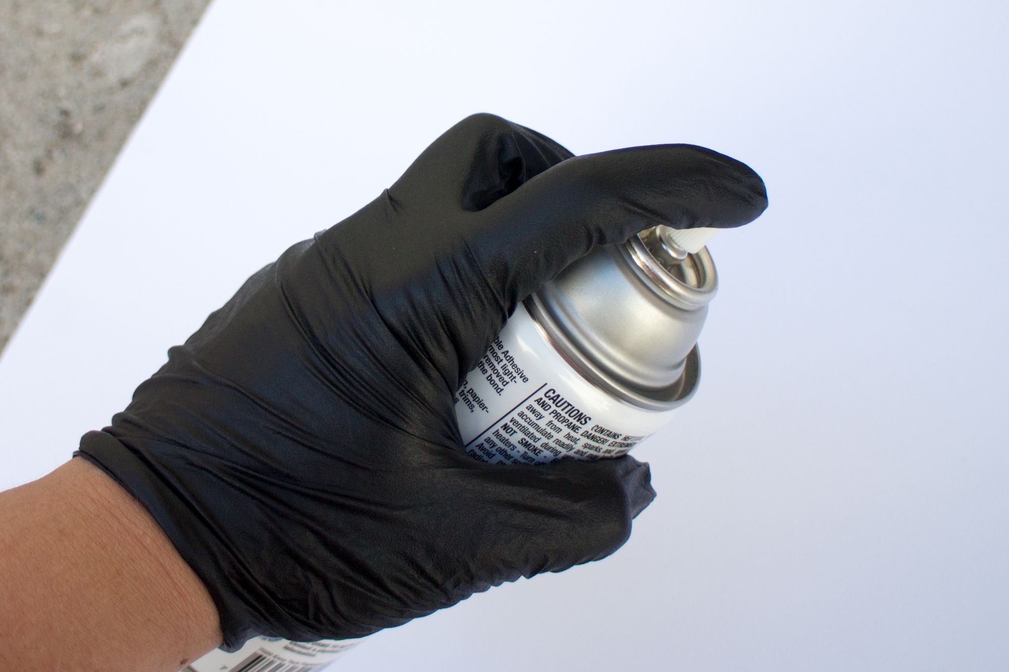

- Spray Adhesive
- Heavy Duty Spring Clamps (optional, just to clip your reflector to anchor it)
I am forever a fan of cheap and easy solutions, I got all the supplies except for the spray glue at the dollar store. For tips on how to use spray glue, check out my previous class that is all about glue!
Wear gloves when applying the spray glue to the foam board. I used a light-tack spray glue so that I could gently reposition the aluminum foil if I started to lay it down crookedly.

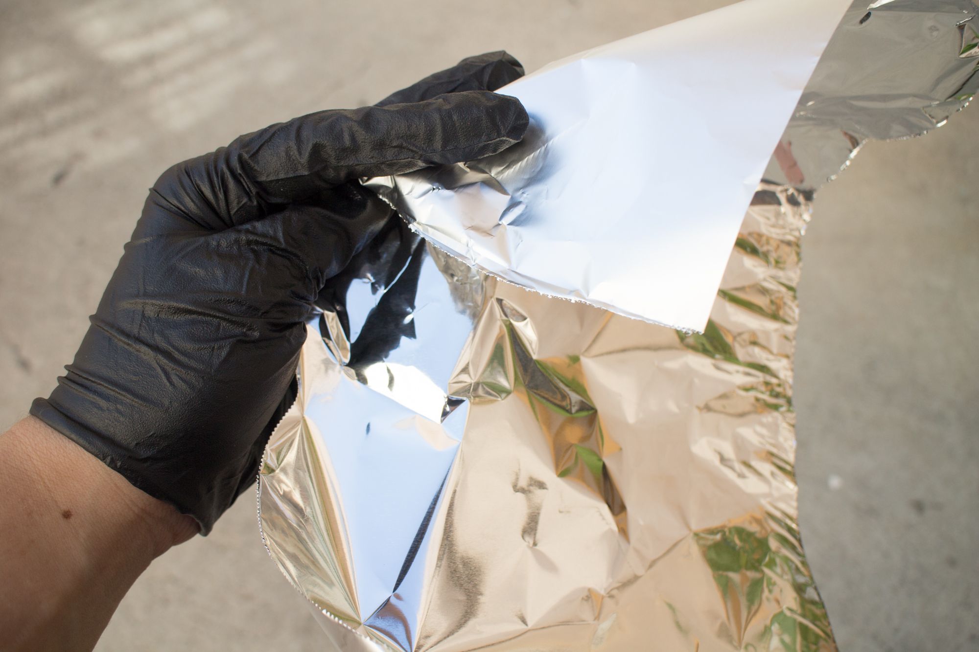

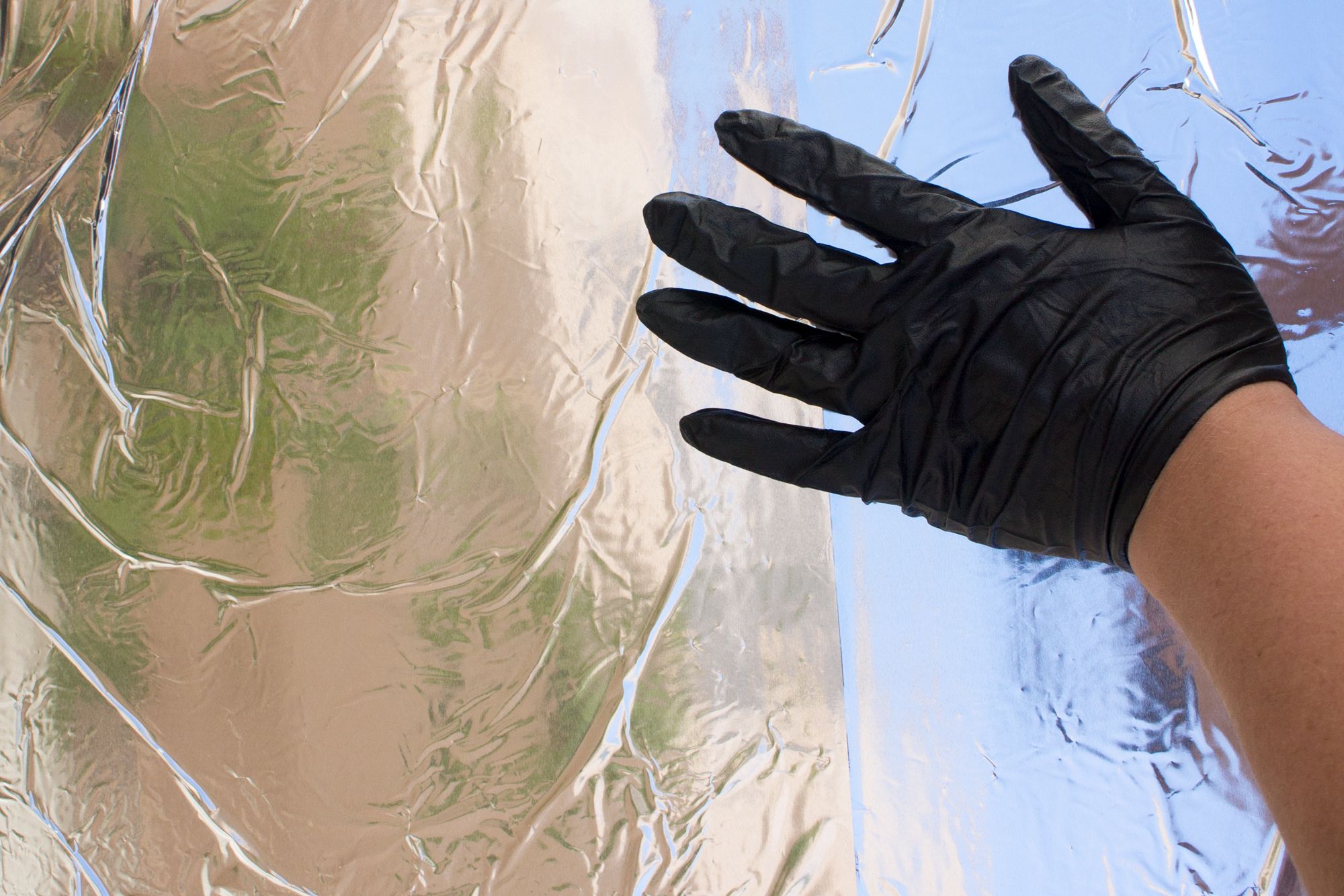

Take note that standard foil has a shiny side and luster side. Use the shiny side if you want a more specular light reflection, and the luster side if you want a softer diffused reflection. For this demo, I chose to show the shiny side. You could even coat the other side of the board with the luster side so that you can have choices when bouncing light back onto your subject
Rip off a sheet of foil that is about the distance of the short side of the board. Gently lay down as many swaths of foil necessary to cover one side of the board.
You can see that I laid down my foil from right to left, with some extra on the edge. You can rub all the wrinkles out very easily, but be careful mating the edges of the foil - get them as close to touching as you can. Removing overlap is a pain.

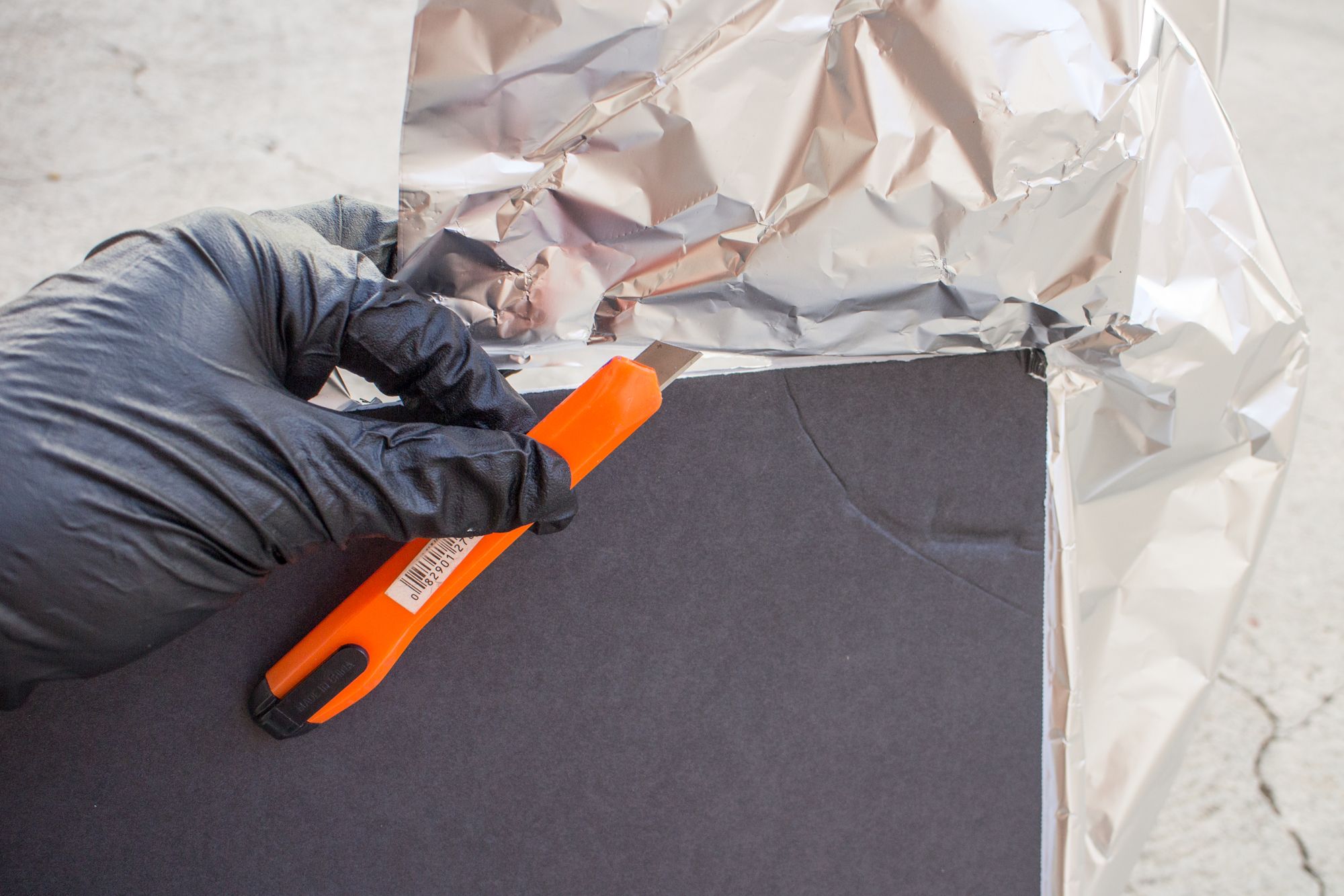

Use a razor blade to trim back the edges of your board. The foil cuts like butter with a sharp blade so be careful to go slow so you don't trim any off that is supposed to be attached to the board.
Here is the board with the trimmed down edges.

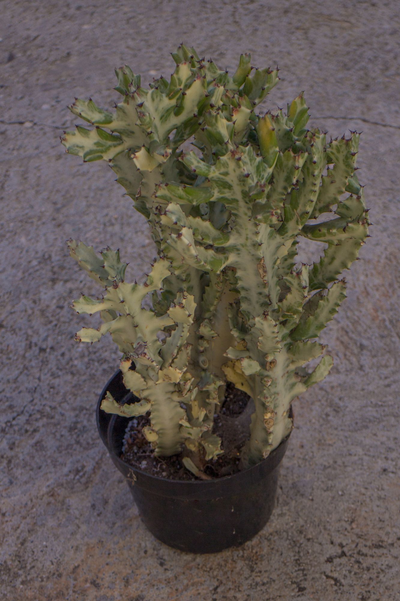

Here is a cute little cactus sitting in the shade outside my studio. He sure is looking underexposed in the shade, but the tonal quality of the concrete background is desirable.
Using a reflector to light the cactus allows you to retain the tonal qualities of the background without having to underexpose the foreground.
