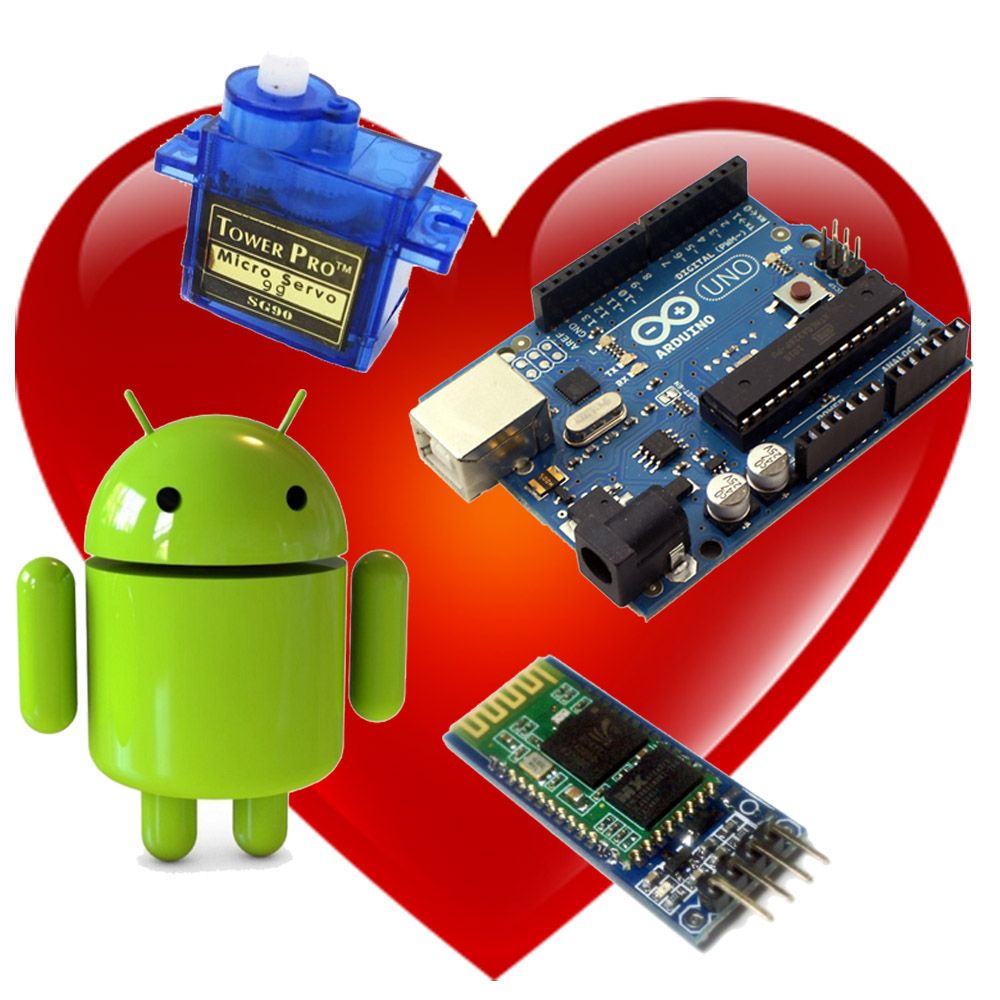

Step 6: Give It Some Guts...
Time to put the electronics into the housing.
Start by inserting the servo into the hole, from the the back of the inside panel (picture 1,2,3).
For now, if the servo isn't snug enough in the hole, just tape it into place (we may have to do some adjusting later).
Now, install the needle, from the front, onto the servo. For now just install it as vertical as possible (picture 4)
How you install the Arduino and Bluetooth module is really up to you.
All I did , eventually, was to just glue them to the back of the inside panel with small small drops of hot glue. It should be easy to remove them if I ever wanted these parts back.
In the photo above, I just have everything sitting loosely, and the Bluetooth module is plugged into a breadboard for now.
Once you have the components in, wire everything back together and power it on.
In the next step we'll adjust the movement of the needle and servo.
