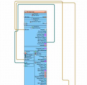

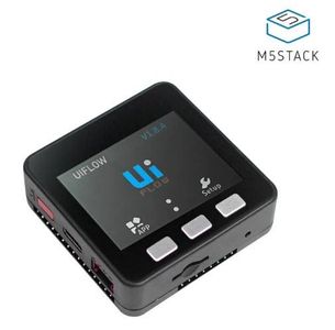

Start Visuino as shown in the first picture Click on the "Tools" button on the Arduino component (Picture 1) in Visuino When the dialog appears, select "M5 Stack Core" as shown on Picture 2

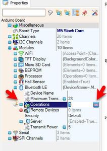

- Select "M5 Stack Core" and in the properties window expand "Modules" > "Bluetooth LE" > "Operations" and click on the 3 dots button.
- In "Operations" window drag "Search Bluetooth Devices" to the left side

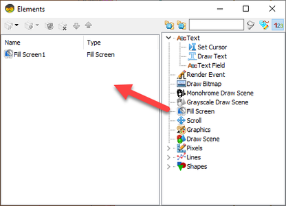

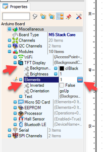

- Select "M5 Stack Core" and in the properties window expand "Modules" > "TFT Display" > "Elements" and click on the 3 dots button.
- In the "Elements" window drag "Fill Screen" to the left side and close the window
Step 4: In Visuino Connect Components
- Connect "M5 Stack Core" pin Out (B) to "DigitalMultiSource1" pin [In]
- Connect "DigitalMultiSource1" pin [0] to "M5 Stack Core" > "FillScreen1" pin [Clock]"
- Connect "DigitalMultiSource1" pin [1] to "M5 Stack Core" > "Search Devices" pin [Scan]"
- Connect "M5 Stack Core" > pin "Device Name" to "M5 Stack Core" >"TFT Display" pin [In]

If you power the M5 Stack Core module and click on the B button, the module will start scanning for Bluetooth devices. After the scanning is finished you will be able to se on the display the names of the Bluetooth devices nearby.
