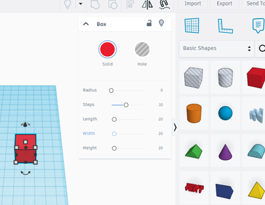

Step 4: Autodesk Tinkercad Workflow
Simple commands:
- View: Mouse wheel scroll to zoom in/out. Middle button for PAN. Right click to rotate view. Also select orthographic view for easier adjustments
- Object: There are basic shapes on the right side as shown in the image. You can drag them on the canvas.Then modify dimensions in the table or drag the geometry itself.
- Holes: Similar to the objects, use the hole option to draw cutouts. Or you can select any object and change it to hole.
- Grouping: Use grouping to combine objects or cut holes from objects.
- Use snap and alignment to make geometry symmetrical.
Thats it! Simple. this is 80% of Tinkercad. One could learn the rest of it intuitively on screen.

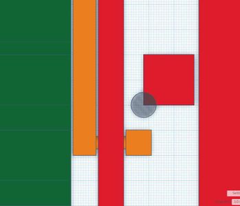

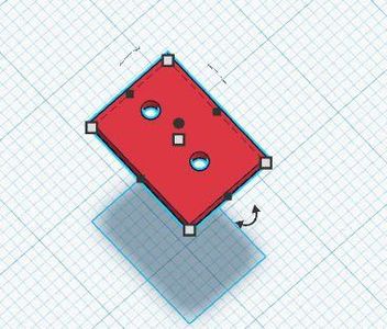

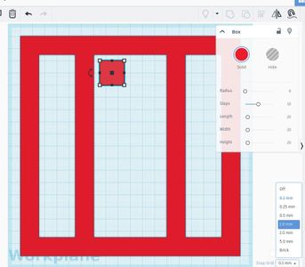

Step 5: Making the Frame
Use one cube for frame and three holes for cutouts

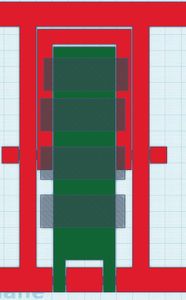

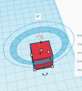

Step 7: Hinge
To make the hinge, you make a rod for the connection and a hole to rotate. Then place them in position.
Step 8: Combine
Combine the stand and give it a different colour as shown.

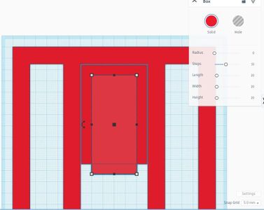

Step 10: Notch
The tip of the notch should not be square for a good fit. it needs to be provided with a chamfer as shown.

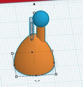

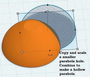

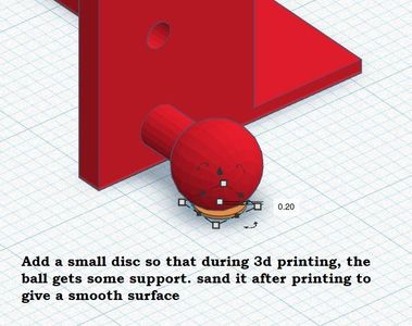

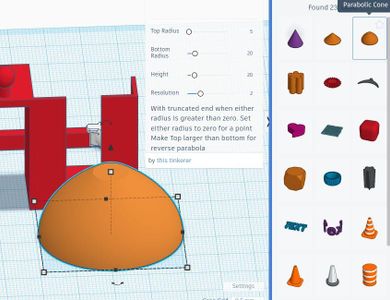

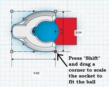

Step 11: Rounding
When the stand rotates, it may protrude against the surface. That is why it needs to be rounded. To round we need a cube and a cylinder hole. the resulting object needs to be changed into a hole then cut it from the yellow part of the stand.

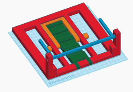

Step 13: Final
- Add the page holder mechanism as shown.
- Add final touches and rounding as required.
- Two small holes are added on each vertical posts for future module addition.A LED bulb for night read or a magnifying glass for elderly readers could be some options of modules.

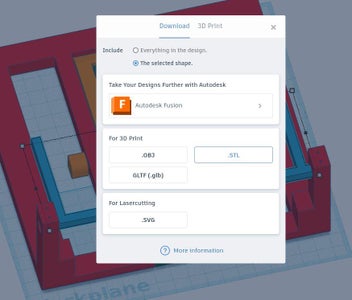

Step 14: STL
Select the files you need to make .stl and export them.

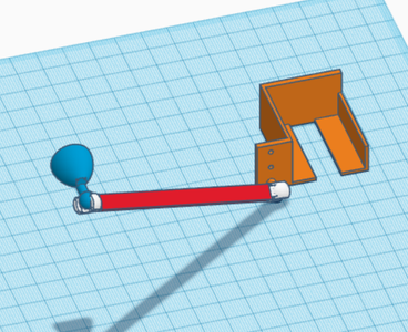

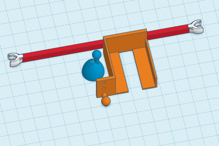

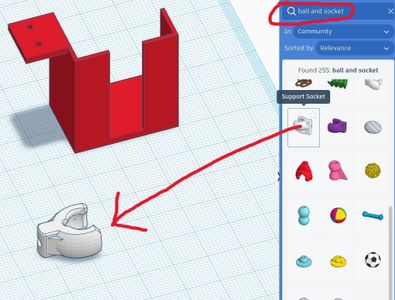

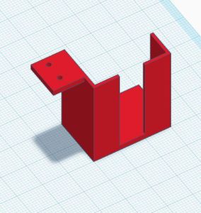

Step 19: Night Light Module
This book holder is made in such a way that you can add modules to it. This is a "Night-reading mode" module that you can add. Now you can read those last pages in the dark without disturbing other people sleeping in the room. You can download the .stl attached. MUST add "Raft" for an issue-less printing .
See the making process in TinkerCAD in the attached images.
I didn't check the longevity of the light but you can use an adapter instead of battery for longer reading. However, I don't recommend reading in dim light for a long time for probable eye issues.)

Step 20: Night Light Connection
- Connect the LED, switch and battery connection properly. Then solder as shown.
- Fix the night light module to the book holder with two screws.
