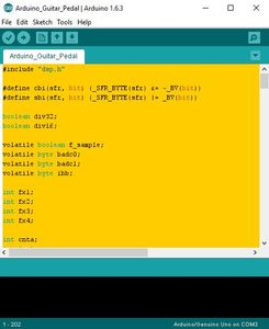

Step 5: Code
#include "dsp.h"
#define cbi(sfr, bit) (_SFR_BYTE(sfr) &= ~_BV(bit)) #define sbi(sfr, bit) (_SFR_BYTE(sfr) |= _BV(bit))
boolean div32; boolean div16;
volatile boolean f_sample; volatile byte badc0; volatile byte badc1; volatile byte ibb;
int fx1; int fx2; int fx3; int fx4;
int cnta; int icnt; int icnt1; int icnt2; int cnt2; int iw; int iw1; int iw2; byte bb;
byte dd[512]; // Audio Memory Array 8-Bit
void setup() { setupIO();
// reload wave after 1 second fill_sinewave();
// set adc prescaler to 64 for 19kHz sampling frequency cbi(ADCSRA, ADPS2); sbi(ADCSRA, ADPS1); sbi(ADCSRA, ADPS0); // 8-Bit ADC in ADCH Register sbi(ADMUX, ADLAR); sbi(ADMUX, REFS0); cbi(ADMUX, REFS1); cbi(ADMUX, MUX0); cbi(ADMUX, MUX1); cbi(ADMUX, MUX2); cbi(ADMUX, MUX3); // Timer2 PWM Mode set to fast PWM cbi (TCCR2A, COM2A0); sbi (TCCR2A, COM2A1); sbi (TCCR2A, WGM20); sbi (TCCR2A, WGM21); //Setup for Timer2 cbi (TCCR2B, WGM22); // Timer2 Clock Prescaler to : 1 sbi (TCCR2B, CS20); cbi (TCCR2B, CS21); cbi (TCCR2B, CS22); // Timer2 PWM Port Enable sbi(DDRB, 3); //cli(); cbi (TIMSK0, TOIE0); sbi (TIMSK2, TOIE2); iw1 = badc1;
void loop() {
//check status of the effect potentiometer and rotary switch readKnobs();
// ************* // ***Normal*** // *************
if (fx1 == 0 && fx2 == 0 && fx3 == 0 && fx4 == 0 ) { byte input = analogRead(left); output(left, input); }
// ************* // ***Phasor*** // *************
if (fx4 > 100) {
fx1 = 0; fx2 = 0; fx3 = 0;
while (!f_sample) { // wait for Sample Value from ADC } // Cycle 15625 KHz = 64uSec PORTD = PORTD | 128; f_sample = false; bb = badc1; dd[icnt1] = bb; // write to buffer fx4 = iw * badc0 / 255; // scale delayed sample with potentiometer iw1 = dd[icnt2] ; // read the delay buffer badc0 = badc0 / 20; // limit value to 512 icnt1++; icnt2 = icnt1 - badc0; icnt2 = icnt2 & 511; // limit index 0.. icnt1 = icnt1 & 511; // limit index 0..511 iw2 = iw1 + bb; iw2 = iw2 / 2; bb = iw2; OCR2A = bb; // Sample Value to PWM Output
PORTD = PORTD ^ 128; output(left, PORTD); // Output }
// ************* // ***Flanger*** // ************* if (fx3 > 100) {
fx1 = 0; fx2 = 0; fx4 = 0;
PORTD = PORTD | 128; f_sample = false; bb = dd[icnt] ; // read the delay buffer iw = 127 - bb ; // substract offset fx3 = iw * badc0 / 255; // scale delayed sample with potentiometer iw1 = 127 - badc1; // substract offset from new sample iw1 = iw1 + iw; // add delayed sample and new sample if (iw1 < -127) iw1 = -127; // Audio limiter if (iw1 > 127) iw1 = 127; // Audio limiter bb = 127 + iw1; // add offset dd[icnt] = bb; // store sample in audio buffer icnt++; icnt = icnt & 511; // limit bufferindex 0..511 OCR2A = bb; // Sample Value to PWM Output
void readKnobs() { fx1 = analogRead(1); fx2 = analogRead(2); fx3 = analogRead(3); fx4 = analogRead(4);
void fill_sinewave() { float pi = 3.141592; float dx ; float fd ; float fcnt; dx = 2 * pi / 512; // fill the 512 byte bufferarry for (iw = 0; iw <= 511; iw++) { // with 50 periods sinewawe fd = 127 * sin(fcnt); // fundamental tone fcnt = fcnt + dx; // in the range of 0 to 2xpi and 1/512 increments bb = 127 + fd; // add dc offset to sinewawe dd[iw] = bb; // write value into array
//****************************************************************** // Timer2 Interrupt Service at 62.5 KHz // here the audio and pot signal is sampled in a rate of: 16Mhz / 256 / 2 / 2 = 15625 Hz ISR(TIMER2_OVF_vect) {
PORTB = PORTB | 1 ;
div32 = !div32; // divide timer2 frequency / 2 to 31.25kHz if (div32) { div16 = !div16; if (div16) { // sample channel 0 and 1 alternately so each channel is sampled with 15.6kHz badc0 = ADCH; // get ADC channel 0 sbi(ADMUX, MUX0); // set multiplexer to channel 1 } else { badc1 = ADCH; // get ADC channel 1 cbi(ADMUX, MUX0); // set multiplexer to channel 0 f_sample = true; } ibb++; ibb--; ibb++; ibb--; // short delay before start conversion sbi(ADCSRA, ADSC); // start next conversion }
