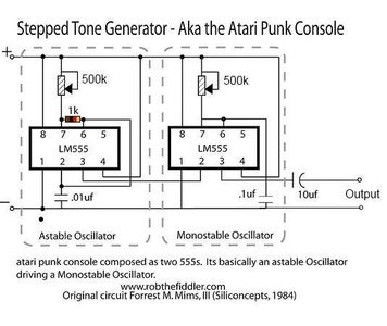

Step 1: Previous Edition - Stepped Tone Generator AKA Atari Punk Console
The Previous edition that I made a few weeks ago was based on the original Atari Punk Console was first made by Forrest Mims in 1980. It utilizes an astable multivibrator setup which triggers a monostable setup. by combining these two setups, we get a Stepped Tone Generator or an atari punk synth.
This was easy to make but I was not pleased with its result.
A year ago, I've made a similar synth with Mozzi Library which worked quite nicely so I thought why not use Mozzi in the V2 of Neko Punk Synth, to make things super cool, I used sliding pots which gives this synth its cyberpunk-ish looks.

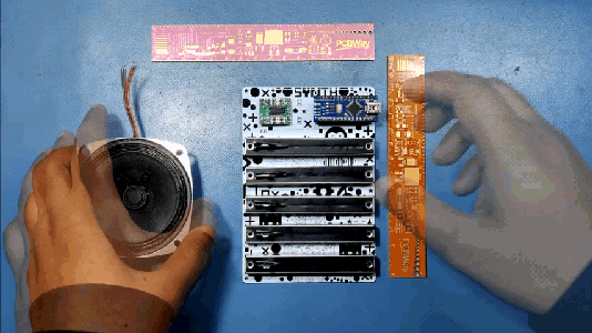

Step 2: Circuit Designing
V2 PCB was probably the simplest Circuit board that I have ever made.
It uses an Arduino Nano as a base Microcontroller, five slider pots are connected with Arduino nano.
D9 goes into the input of the PAM8403 Audio AMP Module and the output of PAM8403 is connected with two CON2 Pins so we can add Speaker with it.
I prepared the PCB in my OrCad PCB Suite and added a few graphics to increase the aesthetic of the Board.

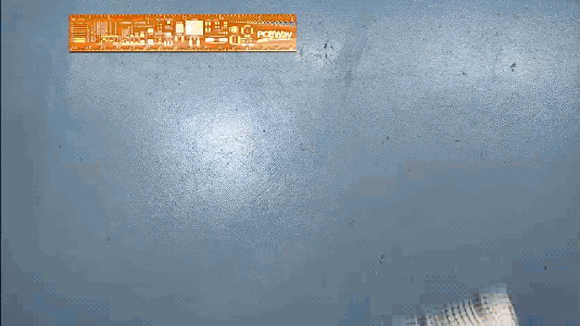

Step 4: Getting the Board From PCBWAY
I used PCBWAY PCB Service for this project. I uploaded the Gerber file of this project on PCBWAY's quote page.
For this Synth Board, I choose white solder mask color as I have added Quite a few round graphics and custom art on the TOP side of the Board.
Black silkscreen looks awesome with white soldermask color.
I received the PCBs in a week and the PCB quality was pretty great, This PCB is Huge and I like how the quality of these PCBs was not compromised because of size.

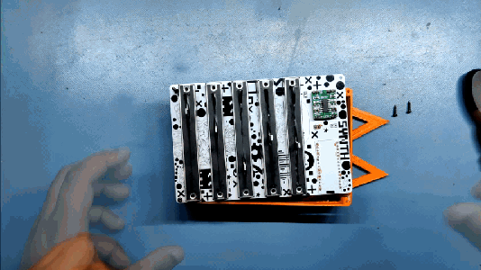

Step 5: PCB ASSEMBLY
Now this Board doesn't have any SMD Componenets so we only had to place everything on this board manually and solder them with a soldering iron.
  • I first gather all the materials and started the assembly process with Slide Potentiometers.
  • I then put all the Pots in their place from the top side and solder their pads from the bottom side of the PCB.
  • After this, I added Arduino Nano and PAM8403 modules in their place, and the assembly was pretty much completed.

The POTs are connected on A0, A1, A2, A3, A4 and the Audio Out is D9.
Step 7: Testing

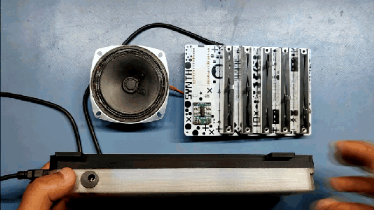

Now after uploading the sketch, I added a 4ohm speaker with CON2 of the PAM8403 Module.
To power this setup temporarily, I've used a power bank to supply 5V 2A to Arduino Nano.
To Modulate sound, we just have to change the position of all 5 sliding pots and that's pretty much the whole testing process.

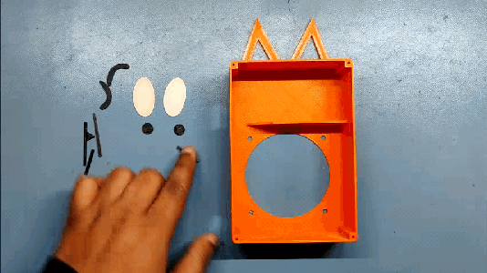

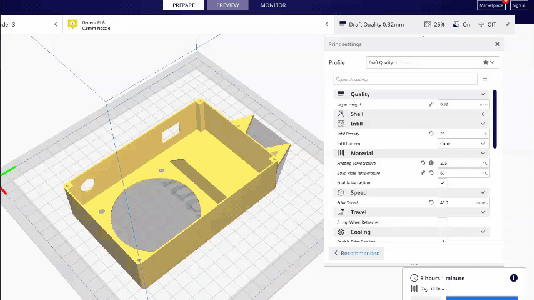

Step 8: 3D Printed Enclosure
As for the Body of the Synth, we generally use a Box like enclosure that will house the speaker and electronics.

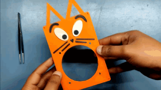

I had this idea of making a cat face on the front side to make it look like a BOX CAT, I added the cat's facial things like whiskers, nose, eyes on the front side.
I modeled the body in fusion360 and then 3D Printed each part on my ender 3.
I prepared the main body with Orange PLA and pupil, eyebrows, whiskers, and nose from BLACK PLA and the eyes from white PLA.
The print setting was normal as well, I used a 0.8mm nozzle with a 0.32mm layer height with an infill of 20% and support for the base body.

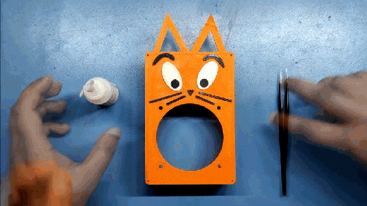

Step 9: Adding Facial Features on 3D Enclosure
After printing all the parts, I used super glue to attach all the face parts to the base body.

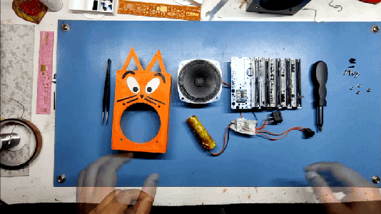

Step 10: FINAL ASSEMBLY
Now we start the main assembly by first adding we add a speaker onto the Base body with nuts and bolts.
Next, I added DC Jack and the rocker switch into the base body.
then we connect the Lithium Boost module with the DC jack and switch.
I then place all the stuff inside the body and add the main PCB from the bottom side with some M2 Screws and the assembly is completed.

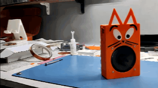

Step 11: RESULT
To Turn ON this setup, we just have to press the Rocker Switch and change the sliding pot position to modulate sound.
