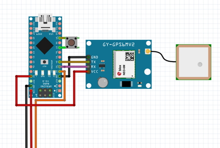

Step 1: Wiring
For this step, we have to solder the GPS device to our Arduino:
- The TX Pin of the GPS can be connected to any digital pin however I have connected it to digital pin 4.
If you do decide to change the TX or RX pin numbers just remember to change them in the code as well.
- Similarly, the RX pin can be connected to any digital pin. I have connected it to digital 3.
I have made this module so that it doesn't need this pin to operate thus it is not crucial however it can be useful in the future if you wish to have more functionality with your GPS device. It should be noted that many GPS's can only have 3.3v supplied to this pin so a logic level converter or voltage converter may be required for this functionality.
- The Vcc of the GPS (Voltage in) is connected to my 5v power supply on the Arduino however your GPS may require 5v or 3.3v input so connect this pin to the suitable one on the Arduino.
- The ground pin of the GPS can be connected to any ground port of the Arduino.
Soldering the servo cable to the Arduino:
- The ground (usually black or brown) can be connected to any ground pin on the Arduino.
- The live wire (usually red or the middle cable) supplies power to the Arduino therefore it should be connected to the Vin pin on the Arduino.
- The signal wire (usually white or yellow/orange) is optional, and I connected this cable to digital 2 on my Arduino.
This cable is required for transferring live data between the Arduino and the receiver however if you opt to do this it must be connected to a suitable port on the receiver and usually cannot be connected to the standard PMW output ports. This may require a different connect on the end than the male servo pin I have.
Soldering the switch:
- The switch can be soldered to any 2 remaining digital pins on the Arduino. I have soldered mine to digital 7 and 9. The switch only has to transmit a High or Low signal to the Arduino when it is pressed.
I would use a multimeter to double check that the 2 pins you are soldering to the Arduino only connect when the switch is pressed. If you use different pins than I have used you will have to update the code so it works with the switch on the different pins.
In my pictures of my GPS module all of the cables and switch are compact, this is due to the limited size of the RC plane which I want it to go in, you don't have to make the cables this size however it will be easier to print a case and make your module small. Now that everything is soldered, we can move onto the next step:
