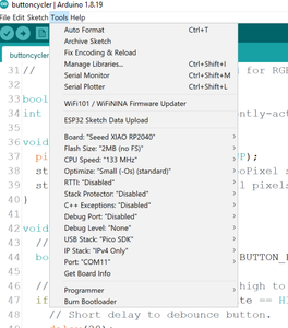

Step 6: Arduino Program
Arduino program is a slightly modified example code "buttonCycler" from Adafruit NeoPixel library
Modify the pin assignment as per the electrical diagram
  • Button PIN as 3
  • PIXEL PIN as 4
  • PIXEL COUNT 18
  • BRIGHTNESS
  • 0 - 0%
  • 255 - 100%
Upload the code with rocker power switch OFF (Since the fan consumes more current, few PC USB ports cannot deliver the current)
Unplug from PC, connect to USB power brick and power ON to test the code

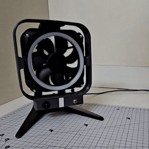

Setup frame is hung on the headphone stand similar to a headphone 🎧, USB-C is connected in the back
FAN can be flipped direction 🔃 to change the air flow direction by flipping the fan and 90 deg to the bracket
Step 8: Here It Is..
Wrapping it up!
