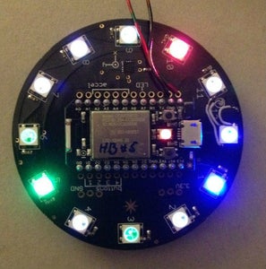

Introduction: NeoPixel Clock With SparkCore Internet Button Shield
The Spark Core Internet Button Shield only has 11 NeoPixel LEDs, but has space for and practically screams for the 12th LED to complete the circle.
And what could be more fun than making a fascinating clock with Internet connected LEDs?!
HackBergen participated in the Spark Core November 2014 Build Night, and it is nice to make something that can be reprogrammed and extended later on.
So this is a Spark Core with Internet Button Shield, installed in a cheap promo-gift clock casing and powered by a USB cable.
It is easier to read than a Binary Clock, but still a bit more challenging and interesting than a normal one.. :)
After having it in the living-room for a while it has proven that the LEDs are very usable in a darkened room and works very nice as a companion to the TV.

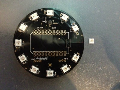

Step 2: Start Soldering

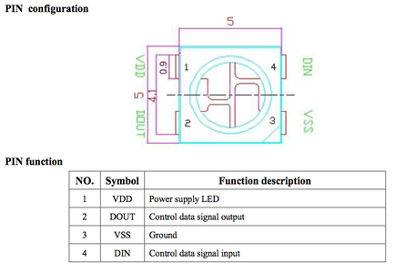

Soldering SMD components can at first seem daunting, but with enough light, a good soldering iron and a little practice, is quite do-able.
Important tips:
  • Use same orientation as the mounted chips.
  • Use extra long wires to ease mounting.
  • Use only as much solder as is really needed.
  • I used TackIt to hold the chip while soldering, but a second hand or anything similar will probably do.

Colors as shown:
  • Red = hours
  • Green = Minutes
  • Blue = Seconds
Step 4: Adjust Angle and Glue Chip to Board
Remember to make space for the USB cable to be connected to the Spark Core itself. Hold the chip down while the glue dries so it mounts as close to the board as possible.
I tried to use hot glue, but it was hard to get the chip to be flush to the PCB. Some type of sticky glue will probably be best, as long as it does not conduct electricity.

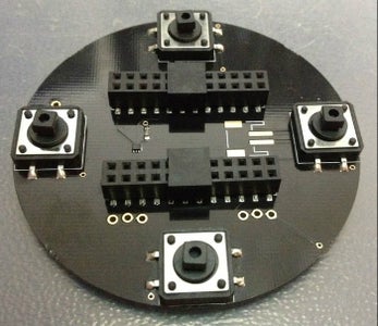

Step 5: Make Inlay to Hold Shield and Perfboard Together
As the Internet Button Shield has no holes for screws, I used the back part of the header connector on the shield to hold a perfboard with the inlay in-between. The inlay had to be carefully made, so the shield would be placed in the middle of the clock casing. As an added bonus, the header pins on the perfboard make it easy to solder in the USB cable for power supply later on.

Step 7: Add Header Male Pins and Fasten Inlay Into Casing
I used 4 x 2-pin headers. If more are needed for adding more sensors later on, those are easy to add if needed.
As seen in the first picture, I had to file down some of the plastic on the header pins to make the sandwich fit as flush as possible. (0.5mm or so was filed down here.)
We only need 2 pins to power this project, but only one pin in each of the other corners seems a bit too little to create enough friction to hold the "sandwich" together.
Solder the pins in while inserted into the shield to hold the pins in the correct positions.
