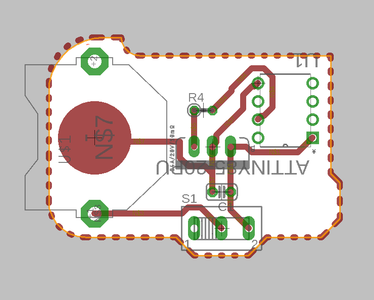

Step 3: PCB Design in EAGLE
To fabricate the PCB I used EAGLE to create a .brd file in conjunction with a DRC provided by the Othermill's resources. Using a custom DRC in an EAGLE file ensures the machine will accurately fabricate based on your design. See Bantam Tools resources:
https://support.bantamtools.com/hc/en-us/articles/...
Specifically, I used the 1/32" flat endmill and a single-sided FR-1 copper board. If you do not have access to a PCB mill, you can follow the circuit design per step 1 on protoboard. Follow the next steps to bring this design into reality.
