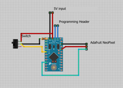

To build this device You'll need a few parts!
-1 Arduino, I prefer Nano's
-A length of Adafruit Neopixels, use a segment of 5 if you don't want to change anything in my code
-A Switch
-A 1K resistor
-Breadboard, wire, pcb, anything to hook it all up.
The wiring is real easy, just hook it up like on the schematic. For short lengths of LED strip like in this project, you don't need to use external power.
The switch is to switch between display and program mode, if you are writing a new pattern to the device, put it in program mode to make sure you don't miss a bit.
