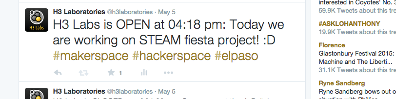

- The message will be sent by the RPI along with the time at which the status was updated to Twitter (pictures)

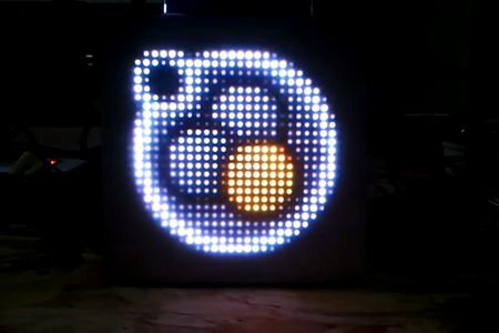

- The message will be displayed on the led matrix in a horizontal scrolling fashion

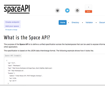

- The Status is changed on a file by the RPI which can be later be read by http://spaceapi.net/ to update our status.
- The Status is displayed on the led matrix by two different pictures which are scrolled across the screen

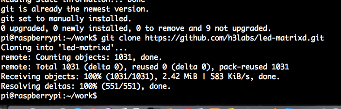

First login to your RPI using ssh. I assume you know how to do that, else just google it, there are plenty of ways to do it.
- run the following commands
- sudo apt-get install gcc make build-essential git
- mkdir work/
- cd work/
- gem install bundler -v 1.10.4
- git clone https://github.com/h3labs/led-matrixd.git #to get the code on your RPI

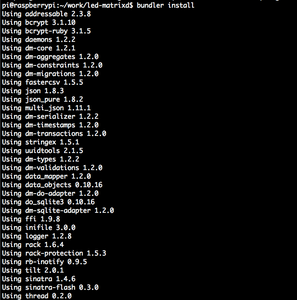

After having setup the code on your RPI run the following commands, which will basically compile a library that is used to change the led matrix leds in many awesome ways.
- cd led-matrixd
- bundler install #to install all the ruby gems
- git submodule update
- make
- make install-init #this will install the daemon to run every time the RPI starts
- make install #just to install all the libs and code of the RPI
