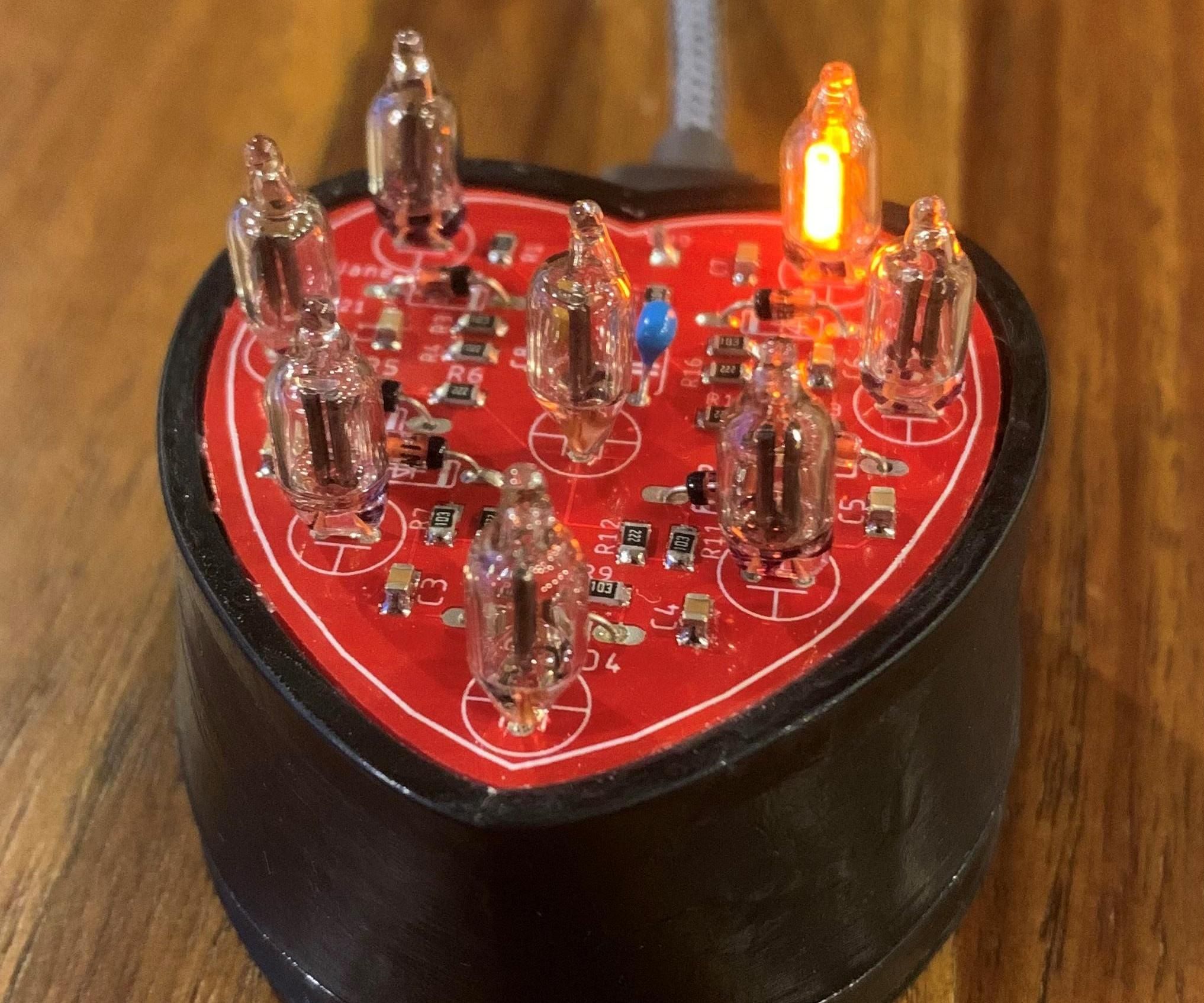

Introduction: Neon Lamp Tea Light
Updated: Now it's easy to order the PCB for this project directly from PCBWay! Here's the link: https://www.pcbway.com/project/shareproject/Neon_Lamp_Tea_Light.html
Neon lamps, also known as neon glow lamps, are wonderful little bulbs that glow orange when you give them high voltage and low current. Neon lamps are mostly obsolete now; they belong to an era when many electronic devices were supplied with high voltages in order to drive vacuum tubes, and the voltages required for neon lamps were convenient and accessible. Compared to an LED which might have a voltage drop of 3V, a neon lamp's striking voltage on the order of 100V makes it impractical for use in modern circuits, which use transistors instead of vacuum tubes and require much lower voltages.
However, neon lamps look really cute! They deserve better than to be consigned to the history books, thrown out in favor of surface-mount LED's lacking any sense of personality. With this in mind, I decided to create a small, portable neon bulb light. I wanted my creation to have these properties:

Now we can put the whole circuit together! This is a screenshot of my schematic in Autodesk Eagle, which I downloaded for free with an education license (there's also a free version you can get without an education license or paying). I chose Eagle because I've seen lots of people online use it, and there are a lot of tutorials out there. The only complication I had converting my LTspice schematic into a schematic in Eagle was that I was using some components that didn't appear in the Eagle standard libraries. I found some online using SnapEDA, and I had to create my own libraries for some others. I've uploaded my schematic file here, along with all the libraries.
The only new thing with this schematic is a switch added between the battery and the LT1073 (although the battery is still connected directly to the charging circuitry). As you'll see on the board in the next section, the footprint of this switch isn't an actual switch; it's just two vias (electrically connected holes) next to each other. The idea is that I can solder wires into the holes and connect those to a switch somewhere, or just solder them together if I don't end up needing a switch.
One more thing is that I have two resistors (R3 and R10) in series. This is because I wanted a 26.2kohm resistor in order to get an output of exactly 81V to the neon lamp, but the variety pack of surface mount parts I ordered didn't include resistors with that value (no duh). Each component in a schematic in Eagle represents a physical part which has a physical footprint on the board, so you have to be mindful about the final PCB even when you're designing the schematic.
Step 6: Design the PCB in Eagle
Now we place components and route traces! The wireless charging coil I picked fits within a circle of about diameter 40mm, so I wanted to fit all the circuitry on a circular PCB of that size. That meant I had to use some surface mount resistors and capacitors.
There are three common sizes, or 'packages', for surface-mount resistors and capacitors: 1206, 0805, and 0603, where the digits say how long and wide the packages are. For example, a 1206 resistor is a tiny box 0.12 inches long and 0.06 inches wide - that's tiny! These different packages also have different power ratings (or voltage ratings for capacitors). A 1206 resistor can dissipate 1/4W, an 0805 1/8W, and an 0603 1/10W (here's a handy guide). There are other larger and smaller SMD packages, but these are the most common.
The big advantage to using some surface-mount parts is that it makes my board take up much less space. It also wasn't too difficult to find the parts I needed - this SMD component assortment on Amazon had all the common SMD parts I think I'll ever need, and includes a neat guide to identifying the different components. Of course, we can't naively replace all our components with surface-mount equivalents - in this circuit, L1 needs to be able to handle 1A of current without saturating, D1 D2 and D3 need to be rated for 100V and also be fast-switching diodes, and C1 C2 and C3 need to handle 100V. Maybe there are small, surface-mount components that could meet these requirements, but I couldn't quickly find any, so I stuck with the through-hole versions I already had.
If you look at the image of the board, you'll see that I used 3 through-hole resistors instead of surface mount resistors. These resistors needed to have values that weren't included in the SMD assortment I ordered. In addition, R3 and R10 control the output voltage, so I figured that in the future I could reuse this board as a variable voltage supply by wiring a potentiometer into where R3 is.
The other two notable things are the screw holes in the sides and the four vias at the bottom. These vias are for soldering in the battery and the wireless charging coil. Maybe I should have used a standard connector for the LiPo battery instead, but I thought it would take up too much space and did this.
Oh, also, I opted to use a super tiny surface-mount 0603 red LED as the indicator light for the charge controller. This saved a lot of space, but it was a little tricky to make sure the LED was facing the right way when I assembled it. The SMD component assortment I ordered included multiple colors of 0603, 0805, and 1206 LEDs.
