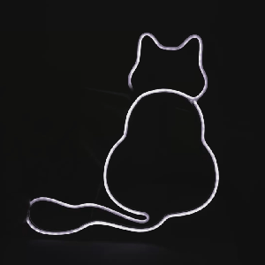

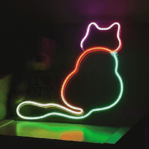

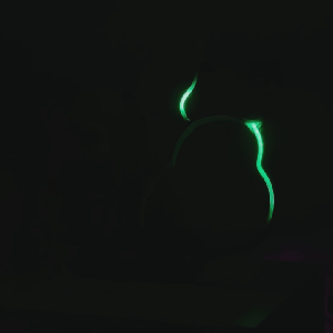

This is my cat🐱.Ever since I moved here, I can only see he through FaceTime.So, I decided to create this neon cat light to keep his presence close.I designed the outline based on his chubby figure and placed it on my bedside table. It’s both a decorative piece and a functional light.

Step 1: Modeling
I used Rhino to design the 3D model of the cat's outline, ensuring the grooves fit perfectly for the LED neon strip.
Step 2: 3D Printing
I printed the outline using a 3D printer, creating a sturdy frame to hold the components and the neon light securely.
Step 3: Assembly
After printing the frame, I placed the LED strip into the grooves, connected the Arduino board and wires, and programmed the buttons to control the light modes.

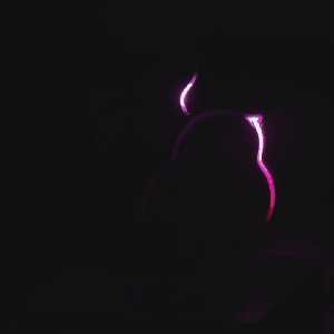

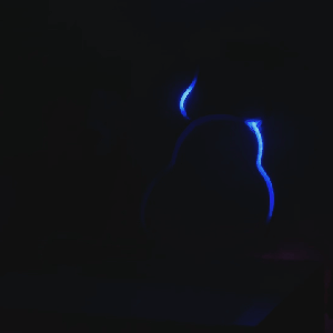

Step 4: Code1
Day Mode: The light flashes like a comet, with each "comet" in a different color. After the comet effect, a rainbow light flows smoothly through the strip.

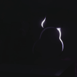

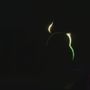

Night Mode: The light switches to a soft white glow that flickers gently, serving as a cozy night light.
Night ModeCode
