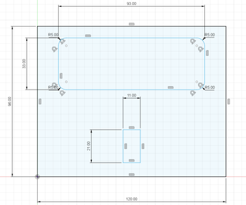

Step 3: Making the Base
I chose oak board for the base.
Outer actual sizes turned out to be slightly larger.
Also, I painted it once with water-based varnish.

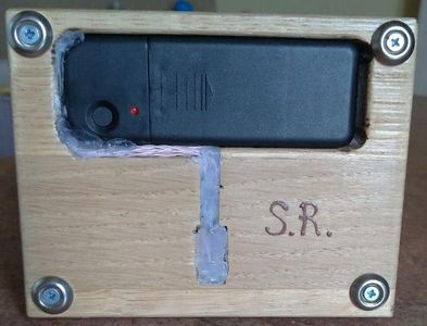

Step 5: Electronics
After connecting the button to the main PCB, I faced false triggering (long wires, maybe noise). To avoid it, I soldered the filtering capacitor of 0.1uF.
To finish up, filled wires with hot glue:)
