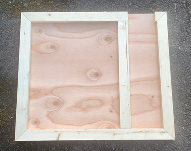

Step 1: Build the Frame
The only wood you’ll need for this build is an 8 foot 1 x 2 and a 2 foot by 2 foot sheet of ¼ inch plywood.
The plywood is going to be cut into a 19 x 21 inch board.
The 1 x 2 will need to be cut into 5 pieces of the following lengths: 2 x 19 inch pieces, 1 x 21 inch piece, 1 x , and 1 x 16 inch piece. All except the 16 inch piece will be cut at a 45 degree angle to form the outside edge of the cutting board.
The 1x2 boards are glued down in the pattern pictured above. It was at this point I realized that this is kind of big so feel free to adjust the dimensions to make a more reasonable sized serving tray.
