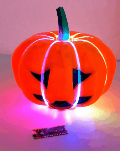

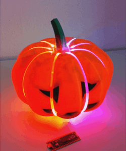

This 3D-printed pumpkin with integrated fiber optics can be printed with or without the face to use it as a Jack O'Latern for Halloween or a deco pumpkin. It uses a cheap Raspberry Pi Pico to drive 9 LEDs which are integrated in the base. The project idea was heavily inspired by @ItsMrJP. The pumpkin has a height of approx. 14mm (6.5 inch) and a diameter of also 14 mm (6.5 inch). It should fit to most of the standard 3D printer bed sizes. There is a cylindric hole in the middle to add batteries if needed. The Pumpkin was designed from scratch with Fusion 360.

The fiber optics are lighted up with 9 addressable LEDs from a 60/LED per meter strip. The LEDs are mounted to the outside of the base and glued to a ring. There is a small cut-out for the wires. These LED strips have double-sided tape on the back, so you can just glue them to the ring as shown in the pictures. The LEDs should be proper aligned to the 9 notches of the pattern to ensure a good fit with the fiber optic.
Cabling is done like this:
VBUS → 5V
GND → GND
GP22 → DIN (you can use any other GPIO also)
Step 4: Inserting the Fiber Optic
Cut the fiber in 9 200mm long pieces. The fiber optic can now be inserted into the channels. For the face version, the painting/inserting of the face should be done before inserting the fiber.
Slightly push the fiber into the channel and push it to the top until it reaches the upper endpoint. Then repeat this at the bottom by inserting the fiber in the hole, push it in and check the fit on bottom and top. Ensure that the fiber is inside the channel and if not, slightly push it in.
Step 5: Cutting the Fiber and Inserting the Base
With a sharp knife cut off the ends of the fiber. Now the base can be slided into the pumpkin. There are 3 notches at the base to align it with the pumpkin. Also the stem can be inserted at the top.
