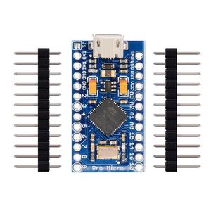

I modeled these for Arduino Pro Micros so they have a place where they can be mounted, hidden on the rear. But any microcontroller will do I guess.

  • Arduino (Pro Micro)

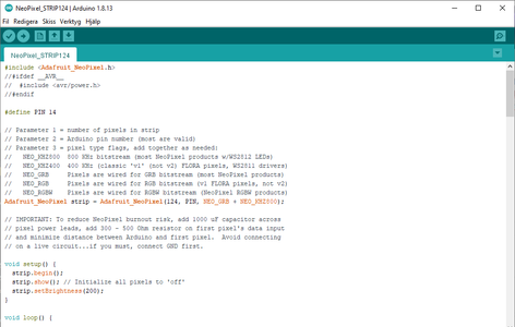

Step 6: Upload the Code to the Arduino
You could write a much more impressive code for these than I did.
I have written a few Arduino projects before but a few years have passed since and coding isn't my strong suit.
So I just took some examples that I found online, customized them a little and put them together in a basic loop.
You could just as well write a program that triggers the lamp by some outside factor. You can do a whole lot with
an Arduino and some kind of sensor, button, doorbell and what not.
I'm curious to see what use or effects you can come up with in regards to the programming.
Just make sure to set the correct amount of LEDs. If you're using some other amount than my 61 and 124 then swap
those numbers out for what you're using.
Also you can use strip.setBrightness(X); to adjust the brightness in order to get down to a safe amperage. Just replace X with (0-255)
