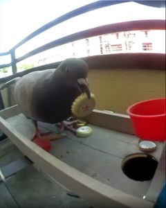

A vending machine for birds that rewards them with food when they drop something in a hole. Electronics and enclosure materials cost <100 USD/EUR. I've designed a PCB and PVC pipe enclosure and dispenser (described below). The circuit is not complex, but I think a custom PCB makes it easier for people who are not electronics hobbyists to build this. I've made a few different enclosures out of scrap for this, but will share the PVC pipe enclosure details since it's sturdy, waterproof, and the materials can all be found at the hardware store.

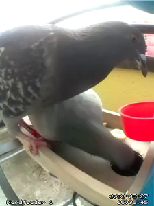

I have been using a Raspberry Pi Zero W with a wide-angle camera module running MotionEyeOS with my vending machine just to record videos with motion detection. Now I am using the GPIO pins to monitor and log events, trigger video recording based on sensor status, show status information on a video overlay, and enable manual record/stop for vide and dispensing of a peanut via the web interface. The python and shell scripts for this are on GitHub: https://github.com/src1138/VMFB/tree/main/motioneye_scripts

I used peanuts in the shell to attract birds to the area and shelled peanuts in the vending machine. If you live in an area with lots of pigeons, using peanuts in the shell will not attract them as much since they can't eat them (can't get the shell off) and you have a better chance of attracting corvids. Shelled peanuts are easier to dispense reliably - peanuts in the shell are less dense, more irregular in shape, and jam easily. Dry cat and dog food also works.
BIRD CONDITIONING
Along with learning and having some fun, the goal is to get a birds to bring something, drop it in a hole, and get a reward. Birds need some conditioning for this, so there are a few phases to progress though to help them figure this out.
Conditioning Stages
0 - Put food in the area you plan to mount the vending machine to start attracting birds
(1-2 weeks)
- Food Provided, Timed Dispense, Deposit Provided
(2-3 weeks)
2 - No Food Provided, Timed Dispense, Deposit Provided
(1-2 months)
3 - No Food Provided, No Timed Dispense, Deposit Provided
(4-6 months)
4 - No Food Provided, No Timed Dispense, No Deposit Provided
Time estimates are based on my own experience over the past year or so, but Phase 3 duration is a guess. As of July 2023 I have not yet seen a bird deposit an item I didn't provide. Unfortunately I had to take my machine down in May due to some new HOA regulations prohibiting feeding the birds in my neighborhood. I plan to redeploy it when I find another suitable location.

The deposit hole in my case is a 50mm PVC joint, large enough for most bottlecaps, cigarette/cigar butts, batteries, etc. It took 3 side-by-side pairs with an extra LED to cover this opening.
DISPENSER
The Dispenser is a two-layer vibration platform with offset holes made from 3mm PVC sheet and 15mm M3 brass standoffs. I used a small 24x12mm 2VDC motor attached to the dispenser with brass standoffs and 3mm PVC sheet.
DEPOSIT
There is a 50mm hole cut in the tray with a 50mm PVC joint used as a chute to the collection jar. There should be only downward slopes, no horizontals else things are likely to get stuck there.
For the deposit sensor, and it's heatshrink backstop it's good to keep tham a cm or so away from the edge of the opening so they don'e get dirty - a dirty backstop will trigger the sensor, and a dirty phototransistor may not see something that is deposited.
