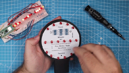

Introduction: Nerdy Clock - Binary Clock Using Pico W
About: Hello, I am Vernon from NerdCave a DIY channel, I focus on microcontrollers and coding.
In this project, we'll be using a Raspberry Pi Pico and some LEDs to create our own binary clock. Why make your own binary clock? Well, for one thing, it's a fun and nerdy way to display the time. But beyond that, it's also a great way to learn about binary and how it works. Plus, building a binary clock is a great way to practice your programming and electronics skills!

I have added two lists below for the components needed either for a breadboard version or a PCB version. The components used are easy to find in most common electronic stores.
Breadboard:
1 - Raspberry Pi Pico W
1 - Breadboard
1 - Micro USB Cable
Wires serveral
17 - 330 Ohm resistors
17 - LEDs
PCB
1 - Micro USB Cable
Wires serveral
17 - LEDs
PCB

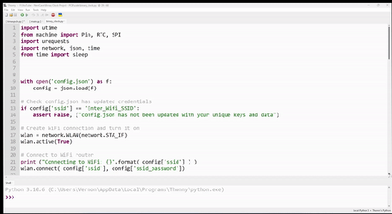

Step 2: Code
In this section we will look at the code required.
The following files should be in your project:
binarypcb.py
config.json
urequests.py
binary_clock.py
Copy these code and upload to the raspberry pi pico with the correct file name. Other option is to download the code from my github repository here: Download. Pick the one relevant to your built the binarypcb.py if you are using the PCB I designed or the binary_clock.py if you are following along on a breadboard.
The code for the binarypcb and binary_clock (breadboard) is exactly the same except for the pinout of the LEDs.
import utime
from machine import Pin, RTC, SPI
import urequests
import network, json, time
# Load the configuration from config.json
with open('config.json') as f:
    config = json.load(f)
# Check if config.json has been updated with valid WiFi credentials
if config['ssid'] == 'Enter_Wifi_SSID':
    assert False, ("config.json has not been updated with your unique keys and data")

  • It splits the date and time into separate strings, converts the date and time strings into integers, and stores them in the year, month, mday, hours, minutes, and seconds variables.
  • It also extracts the day of the year, day of the week, and daylight savings time status from the JSON response and stores them in the year_day, week_day, and is_dst variables.
  • The function closes the response object and sets the RTC object's date and time using the datetime method.
  • If the blocking flag is True and the GET request fails, the function continues to retry indefinitely until it succeeds. If blocking is False, the function closes the response object and returns without setting the RTC time.
rtc = RTC()
sync_time_with_worldtimeapi_org(rtc)
force_sync_counter = 0
if force_sync_counter > 85000: # A little less than a day
    sync_time_with_worldtimeapi_org(rtc, blocking=False)
force_sync_counter = force_sync_counter + 1
  • The code creates an RTC object using the RTC class.
  • It then calls the sync_time_with_worldtimeapi_org function to set the RTC time using the worldtimeapi.org API.
  • The force_sync_counter variable is initialized to 0.
  • The code checks if the force_sync_counter variable is greater than 85000. If it is, it sets the counter to 0, calls the sync_time_with_worldtimeapi_org function again with the blocking flag set to False, and increments the counter by 1.
  • If the force_sync_counter variable is not greater than 85000, the code simply increments it by 1 and does not call the sync_time_with_worldtimeapi_org function.
Define the GPIO pins for the LEDs
hour_pins = [Pin(pin, Pin.OUT) for pin in [15,14,13,12,11]]
minute_pins = [Pin(pin, Pin.OUT) for pin in [10,9,8,7,6,5]]
second_pins = [Pin(pin, Pin.OUT) for pin in [16,17,18,19,20,21]]
This section defines the GPIO pins for the LEDs by creating three lists, one for each time unit (hours, minutes, seconds). Each list is created using a list comprehension to create Pin objects with the specified pin numbers in Pin.OUT mode.
Define a function to update the LEDs based on the current time
def update_leds():
    # Get the current time
    Y, M, D, W, H, M, S, SS = rtc.datetime()
    # Convert the hours, minutes, and seconds to binary strings
    hour_binary = '{0:05b}'.format(H)
    minute_binary = '{0:06b}'.format(M)
    second_binary = '{0:06b}'.format(S)
    print(S)
    # Set the LED states based on the binary values
    for i in range(5):
        hour_pins[i].value(int(hour_binary[i]))
    for i in range(6):
        minute_pins[i].value(int(minute_binary[i]))
    for i in range(6):
        second_pins[i].value(int(second_binary[i]))
This section defines a function update_leds that gets the current time from the RTC using rtc.datetime(). The hours, minutes, and seconds values are then converted to binary strings using the format() method. The function then sets the LED states based on the binary values, using a for loop and the value() method of each Pin object.
Loop indefinitely, updating the LEDs every second
while True:
    update_leds()
    time.sleep(1)
Finally, this section contains an infinite loop that calls the update_leds() function once every second using the time.sleep() function. This loop ensures that the LEDs are updated with the current time every second.
Step 3: PCB Design
To reduce the complexity of wiring, reducing errors, and improving reliability, I designed a PCB based on the schematic. Without a PCB, building the circuit requires manually wiring the components together on a breadboard or a prototyping board, which can be time-consuming and prone to errors. A PCB can save time and ensure that the circuit is consistent and reliable.
Step 4: Case Design
A case has been specifically designed in SolidWorks to house the PCB. You can download the STL file for the case design Here. The case features a simple design that allows for easy mounting of the PCB using M3 screws. Threaded inserts have been used in the original design, but you also have the option to use a M3-25mm screw and nut.
If anyone decides to recreate this project and comes up with an improved design for the case, please feel free to share it with me. I would love to see what you create!"
Step 5: Conclusion
I am planning on using this to build a cyberpunk diorama to display the time using Binary. How will you use your binary clock, let me know in the comments below on instructables or on my YouTube Channel.
