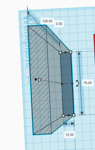

Next in order to hollow out the rectangular shape so the darts can actual be held create another rectangle that is 76 mm long, 12.5 mm wide and 126 mm tall and put it off to the side for later use.

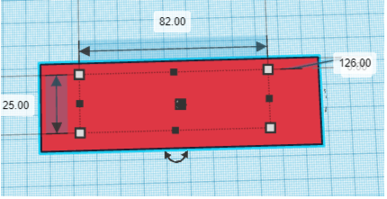

Next create a rectangular hole that is 82mm long, 46.5mm wide and 126mm tall to thin out the side of the original box so it's easier to access the place where the darts will be held and pushed.

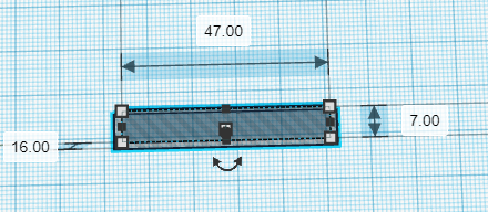

Since with nerf mags there are the obvious fins at the top of the mag so the darts don't just fly out prematurely. So to account for this create a hole that is 47 mm long, 7 mm wide and 16 mm tall to be placed on the side of the speedloader where the backing will be.

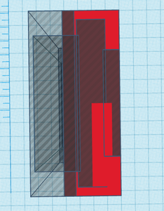

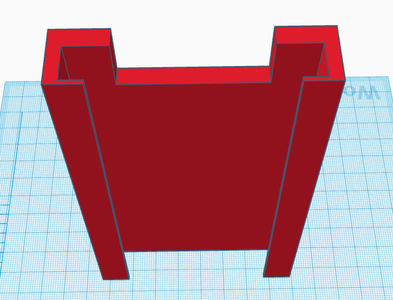

Now that all of the holes have been designed once again take the main unit and all of the holes and bring them into one area. First take part A and place it in the middle of the central box as well as possible, once it's roughly centered use the software's aligning tool to center align both parts. (Center aligning will be used for every part) Next take part B and place it on one of the sides of the box and make sure it's cutting into the center enough so that part of the wall will be cut out. When you center align it make sure it's just enough so that when it cuts through the wall it touches where the dart cutout(Part A) is but no more than that. Then take part C while making sure it's on the side where Part B was previously placed and line it up with the box. Then slowly scoot this piece in until the wall on the main box is about 0.2 mm wide. Finally take Part D and on the other side away from the other parts line it up with the top of the box and make sure it's inside of the box so it cuts out that part properly (Make sure to center align everything before combining!). Once all of the parts are in place you can now combine all of the holes with the main box and get something that should hopefully look like the example image.

Now that the modelling is done you can now export it to a slicing software and start up the printing process of the speedloader(The pictured one took about 3 hours). I recommend if anyone does print this before using to sand down the ends of the speedloader on the inside to make sure that there are no parts inside that the darts can otherwise get snagged on. But once that's done you now have a much faster way to load up magazines before or during a nerf war.
