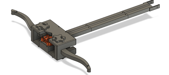

We CADed all of these parts from scratch, with little reference to outside resources.
Our Arm and Gear pieces were by far the simplest to CAD, being only simple extrusions of 2D sketches. The Arm only has one added layer of complexity, which is the notch added on the ends of both arms for the drawstring to be tied to. These Arms and Gears are not actually held onto the frame using rigid connection points, but rather held on by friction with twisted strings, creating a torsion spring mechanism.

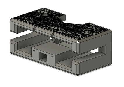

The battery fits into the Frame, which is also what the torsion mechanism is assembled onto through the circular holes located on both the top and bottom of the Frame. The Frame also includes hex nut cut-outs to fit the Flywheel Cage and Front Tray. We added a 3D wooden texture on the top for aesthetic purposes (who likes a boring design?).

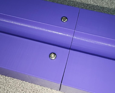

The three tray pieces all slot together using male and female connecting ends, screwed together with hex nuts (hidden in hex inserts) and screws. The Front tray piece features two protruding tabs, as a cut-out to house our switch, and another small cut out at the front of the Front Tray to prevent interference with our electronic components. The Middle Tray piece only has a male and female end, nothing fancy here. The Back Tray piece has a hole that is made for a Lego Technic axle to fit and rotate in (see below for how we designed the crank with LEGO).
We designed all of our parts to be assembledwithout the use of glue, so the ballista can be taken apart and broken down for easier storage. For example, we designed male and female connecting pieces so that the tray pieces can all screw together with hex nuts and screws.

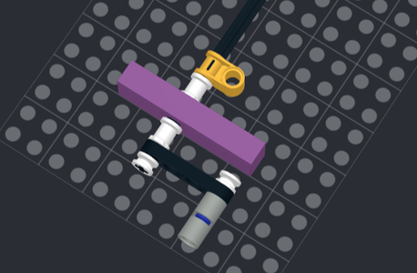

Step 3: CAD LEGO Crank
Due to the relative complexity of a cranking mechanism with a rotating handle, we opted to design this not with conventional CAD, but with LEGO CAD on Bricklink Studio 2.0. The purple brick is a stand-in for our Crank Tray piece. This design is mirrored on both sides, so the required parts are 2x what is shown in the picture, except for the axle.

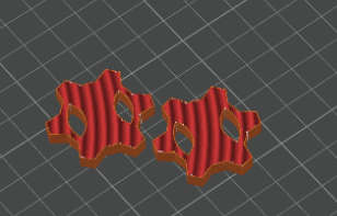

Step 4: 3D Print

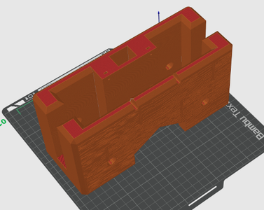

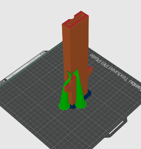

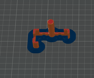

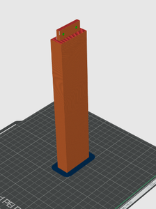

We used a Bambu Lab P1P with Bambu PLA Basic filament, and all of our slicer settings are from their Bambu Studio Slicer program. Your quality and speeds may vary with other printers and filaments. Check screenshots for orientation when printing.
Print Settings:
Frame: Default Settings, Bambu PLA Basic, 0.08 Layer height, no supports, no brim
Flywheel Cage: Default Settings, Bambu PLA Matte, 0.12 Layer height, Supports on Build Plate Only, no brim
Front Tray: Default Settings, Bambu PLA Basic, 0.12 Layer height, Tree Supports, auto-generate brim
Back Tray: Default Settings, Bambu PLA Basic, 0.12 Layer height, Supports, auto-generate brim
Middle Tray, Arms, Gears, Pusher Piece: Default Settings, Bambu PLA Basic, 0.12 Layer height, no supports, auto-generate brim

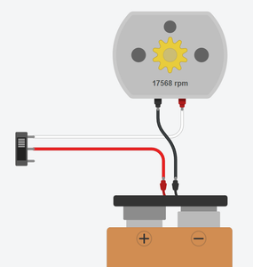

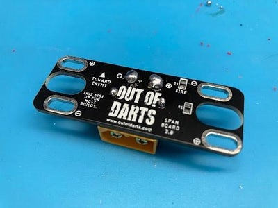

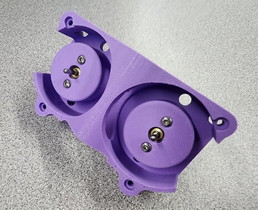

We soldered the XT-60PW connector onto the spanning board as shown.
Next, we screwed both motors into the flywheel cage with four M2 x 6 mm screws, making sure the motors’ positive and negative pins correspond to the symbols on the spanning board in the orientation shown. For our motors, a red dot indicated the positive pin. We then attached the flywheels, hollow side down, by pushing down hard with our thumbs. Since this requires some force, you may instead carefully use a clamp to squeeze the parts together. Before proceeding, we tested that our motors were able to spin, as pushing the flywheels too far down would cause friction, and prevent them from spinning. We did this by simply touching the terminals of a 9V battery to the pins of the motors.
We soldered the spanning board onto the motors by joining the pins of the motors with the metallic edges of their corresponding holes on the board. Note that the side marked “this side up for most builds” is facing away from the flywheel cage, or down. This allows the XT-60PW to fit nicely between the motors. Then, we attached the XT-60 female connector and pushed it in fully. We tested with alligator clips to make sure we soldered the motors in the correct orientation. They should spin in opposite directions and launch darts fed from the back (flat) side of the flywheel cage forwards. If they do not, check if the motors are spinning in the correct direction, or if the flywheels are on too tight, or not pushed down enough.
Finally, we soldered wires connecting the XT-60 female connector, the switch, and the battery clip or power source. Be sure to use flux: we found that the solder otherwise would not stick to the pins of the XT-60 connector. Out of the two connections to the switch, exactly one is to one of the two center pins. Make sure the positive terminal of the battery clip is connected to the side of the XT-60 female connector marked with a +, and the same for the negative terminal. We have provided a circuit diagram that models the flywheel cage assembly with one motor.

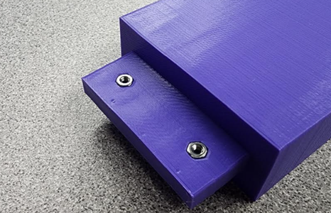

To assemble the feeding tray, we fit hex nuts into the inserts on each tray piece. If the inserts are too small, as in our case, heating the area with a hair dryer may allow the plastic to bend for more tolerance. After heating and inserting the hex nut, the PLA will shrink around the hex nut as it cools, ensuring a tight fit.
We attached corresponding ends together (screw holes with hex nut inserts) and used two pairs of M2 x 12 mm screws and hex nuts to secure all three tray pieces. The tray piece with screw holes on both sides and the tray piece holding the crank mechanism should be on opposite ends with one middle piece in between. See the final assembly for the correct order.

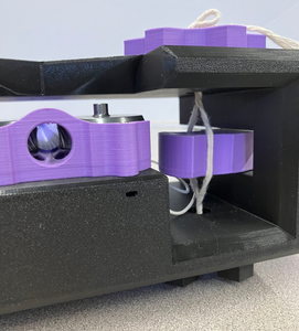

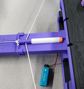

Finally, we prepared the ballista for launching darts. We aligned a pair of gears above and below the frame to the string holes on one side. We recommend pinching both ends of the string together and treating it as a new string of half the length. We looped the string down one side, across the surface of the bottom gear, and up the other side, and tied it securely on the surface of the top gear. Then we fit a ballista arm through the slot on the frame and the space formed by the strings. We twisted the pair of gears at the same rate to add enough torsion for the arm to swing back against the frame, and repeated all these steps on the other side.
We clipped the pusher piece onto the tray and fed a string through the front hole of the pusher piece, looped each end through the groove on its corresponding arm, and tied securely.
We looped one end of another string through the back hole of the pusher piece and tied securely. We tied the other end around a right-angle axle piece on the crank. Lastly, we tested the assembly by using the crank to wind up the string. Make sure to adjust the gears so that the arms swing back symmetrically.
Step 7: Fling Foam!
To use the ballista, pull the drawstring back either using the rotating crank, or manually pulling the pusher piece back with your hand (this allows for much faster, but uncontrolled launching of the darts). Flick the switch, and move the pusher piece forward either by rotating the crank in the opposite direction of how you wound it, or if you manually pulled the string back, just by releasing it.
