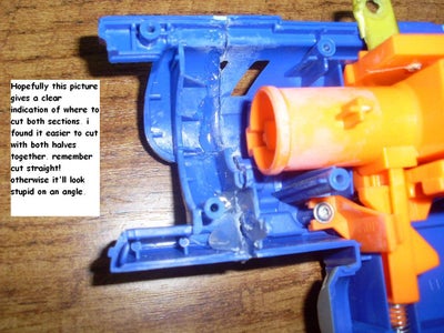

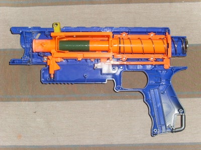

ok so unscrew the gun an open it up. take out the extended barrel (not the one the dart goes in). now look closely at my picture to see where you're going to cut. remember to cut a small section of the barrel to replace the giant one you took out , mine's about 41mm long. once you've hacked up your gun, trim any burrs with a knife and then super glue each half to its corresponding opposite (only glue the blue parts.. dont glue in the orange peices).

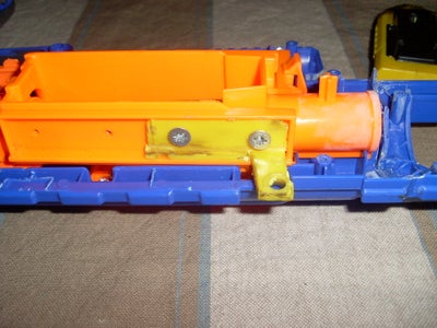

this part is easy, cut out a slot on either side of your gun, mine is 117mm long and starts 70mm from the front of the gun.
the next part is a little hard to describe, so i hope you can more or less guess what i've done...
have a look at the addititional photo ive provided. basically i just cut and used a section of the peice. maybe if you look at the other picture you can see what part ive used... to be honest, you could use anything to do the same job... this was just the first thing i found that i thought might work.
anyway, if you worked it out, you can superglue it in i guess, just make sure if you screw it in, trim the screws that will no doubt go through the bottom, cos your clip has to fit in there....

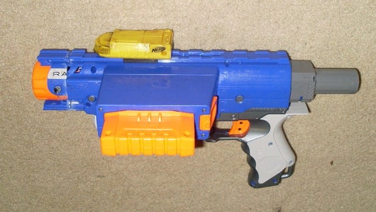

take your cs-6 sight... and unscrew it to remove the black and orange sight thing... reassemble... i then used fire and melted/molded it to be more smoother on my hand...
Attaching it to the gun (gun is assembled at this point):
ok so on the bottom of the sight there is the clip, and a raised bump... cut out the bump so there's a small rectangle hole... i then used fire and heated up around the rectangle, then i pushed the heated rectangle slot over the piece on the gun which was protruding. now it's molded on but can still be removed if needed.... tada! you should now be finished...
