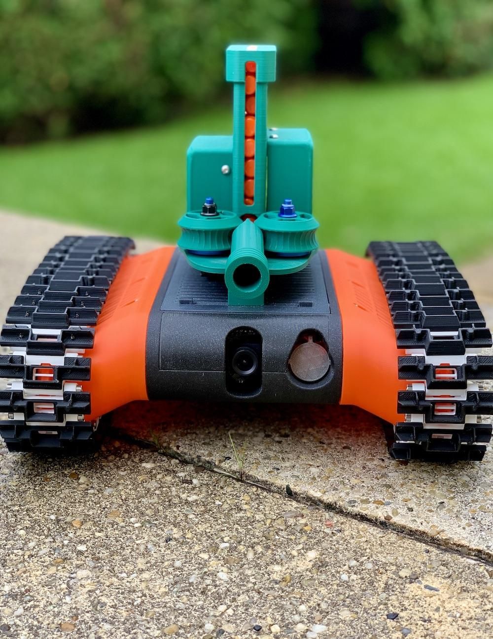

From the beginning of building the FPV-Rover, I wanted to have a Nerf Dart Launcher on it.
And finally, here it is. This is the fifth upgrade for the rover and it won't be the last.

Step 1: Parts to Print
I've printed all parts from PLA, as nothing is critical on this one. ABS, PETG and all other materials would be fine as well.
Go to thingiverse for the most current versions.
1x servo cover
1x battery cover (with or without cutout)
1x dart feeder
1x esc bracket
1x armoured conduit
2x dart launcher
1x base plate (FPV-Rover or FPV-Trike)
1x top plate
1x servo arm extension
1x nerf dart storage
1x top cover
1x 18650 battery pack (if you want to use 18650 batteries like I do)

Step 3: Mounting Parts to the Top Plate
To mount the parts together you'll need a screw driver and soldering station for the motors/esc.
Attach the 360degree servo, the two motors and the esc to the top plate.
Take care of the rotation of the motors. If they spin the wrong way, change two cables to the esc.
Step 4: Mounting Parts to the Bottom Plate
Attach the MG90 servo to the bottom plate using the screws came with. Take care of the right direction, otherwise the mechanism will not work. Don't attach the servo arm to the servo right now. Whait for the next steps.
Step 5: Servo Arm Extension and Nerf Dart Container
You need 8x 2mm x 12mm magnets to attach the top to the Nerf Dart container.
Beside the two screws, you'll need a 2mm x 12mm rod (or whatever with this dimension).
I used a carbon fiber rod I had from other builds.
Step 6: Dart Launcher and Armored Conduit
Attach the dart launcher to the motor. I used two motors with different directions, so that the screws won't come loose.
Step 7: Top Part and Bottom Part
Now it's time to attach the top part to the bottom part.
After doing this, you can screw the servo arm to the servo.
Step 8: Battery Pack
If you want to power your launcher with a battery pack of 16850 batteries, you have to print the battery adapter and solder the batteries to the protection board.
Step 9: Covers (servo and Battery)
Attach the covers for the servo and battery to the rest. Depending on what kind of battery you use, you can select between a cover with a cut out, or without.
