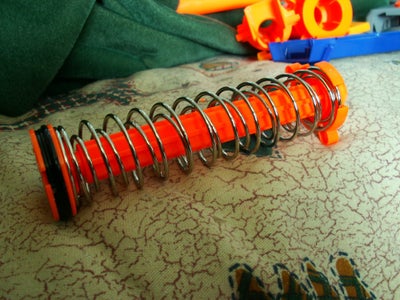

Step 3: Inserting Spring
Thanks for the picture, carrtoon. Take the plunger and separate it into 2 pieces. Take the recon's spring and insert it inside the longshot's spring. Reinsert into plunger chamber and secure with the screws.

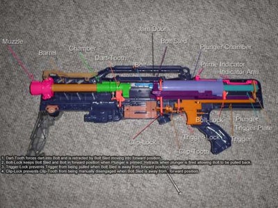

Step 4: Removing the Air Restrictor
(deep breath) Thanks for the picture, Captianslug.com. Remove the bolt and plunger chamber from the gun and pull them apart. Take an electric drill and clear through the bolt, removing everything so it's a tube. Unscrew the back of the plunger chamber and remove the plunger. See the black thing at the bottom? Turn the plunger chamber upside-down and tap the bottom so the other thing falls out. drill out everything in the thing (another air-restrictor) so it looks like a funnel-shaped thing. Put the black connector thing back in the plunger chamber and reconnect the bolt and the plunger chamber, greasing the intersection as much as possible. (breathe out)

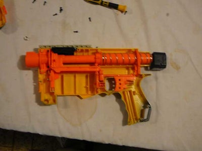

Step 5: Reassemble Longshot and Finish
Put the longshot back together. This (from AR removal step) picture really helps if when you opened it the pieces exploded all over the place. Take the barrel extension from the recon and attach it to the end of the longshot, as a tribute to the $20 you wasted and to make it look cool. Have fun! Note- not responsible for injuries or death caused by this awesome modification.
