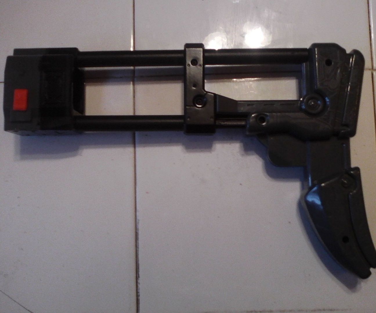

Step 1: Opening the Stock
First remove the 5 screws that hold the stock together & set them aside. You'll see that the orange struts form a U shape inside the back end of the stock. Cut out the center portion of the U Leaving two straight struts as shown.
Step 2: Trimming the Struts
The front end of the stock will now resemble this. Round off the pegs on the end of each strut as I have on the lower one.
Step 3: Test Trimming Size
Grind off the pegs until the Cpvc will slip over them.
Step 4: Fine Tune the Trimming
Cut two pieces of the Cpvc to the length of the exposed part of the struts. Remember always cut long. It's far easier to sand away extra than to come up short & have to start over. Sand the ends of the CPVC smooth and test fit repeatedly until your new strut reinforcements fit snugly in place.
Step 5: Test Fit - Glue ( Optional )
Done properly they will fit quite tightly. For extra strength you may even consider super-gluing the front ends of each to the locking mechanism block. ( optional )
Step 6: Reassemble
Replace the second side and replace the screws. Your improved stock will be far stiffer than the original and still snap on & off almost any gun cleanly.
