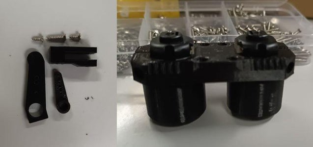

- Turret Parts
Step 1: Print Turret Parts
We started printing turret parts with a 3D printer. Then, you can view the number of each parts:
- 1x Base MG-90s
- 1x Charger 1
- 1x Charger 2
- 1x Bullet pusher 1
- 1x Bullet pusher 2
- 3x Legs
- 1x Recoil arm 1
- 1x Recoil arm 2
- 2x Motor roller
- 1x Servo base L1
- 1x Servo base L2
- 1x DC Motor support

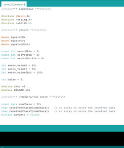

Step 2: Sav-Maker-I Code
We had to program the microcontroller for turret movement and communication. We used Arduino IDE because it make work easier. Sav-Maker-I receives a movement message ("x" or "y" + "number"+ "*"), it maps the number between two numbers that they are the limit and sets movement servos. Also, it receives: a fire message ("d"+"*"), a burst message ("a"+"*") and a reload message ("r" + "*").
Movement message: it receives the mouse coordinates (one character between "x or "y" and the coordinate number) and the last character ("*") means the end of the message. The code maps the coodinate number between two predefined number (0 and 180) and sets the movement servos.
Fire message: if the turret is reloaded and it receives a fire message ("d" character and the last character), it will move the fire servo 100 degrades (reload mode) to 45 degrades (shoot mode).
Burst message: if there are bullets and it receives a burst message, it will repeat the same function that fire message a number of time depending of bullets remain in charge.
Reload message: it resets the counter bullets variable and it enables fire and burst functions.

Step 5: Make the Turret
Finally it's the time to assemble the turret parts. We recommend you: first assemble the turret "legs", secondly assemble the turret "head" and finally join both parts. We suggest you to watch this video if you have any doubt about the process.
Only remains to paste Arduino shield to the turret using double sided tape and to connect pins.
