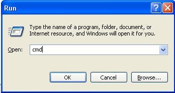

this part is pretty easy, anyone who has used command prompt before knows how to do this, all you need to do is hold down the windows logo key and r to open up run, or you can just go to start>run
once in run, type in cmd or cmd.exe and then press enter
the command prompt shell should now be open

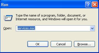

now you are going to have to enable the messenger service. do this by opening up run again, and now you type in services.msc and then press enter
a new window will open up, find the name "Messenger" (no quotes and in alphabetical order)
right click on messenger and select properties.
once in properties on the drop down menu select automatic and then click apply.
once apply is clicked, click on the Start button to start the service
