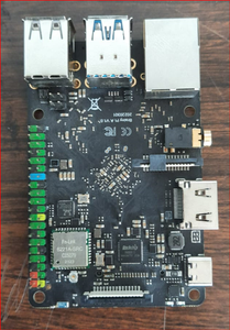

Now as every device is getting wireless why we are using old boring traditional style printers? Wait you don't have to buy a new printer. You can use your old printer wirelessly in fact not only from one device but can access it through multiple devices, sound interesting right? So let's convert our old boring Printer into an interesting one. You just need a brainy pi and software(CUPS). The software allows you to move the printer to wherever you want and have it accessible by multiple computers rather than having it connected straight into a single computer.
It’s also a great way to share a printer without needing a costly tower computer running all the time.
Printer
Brainy pi
Ethernet/Wi-Fi
Sd card
