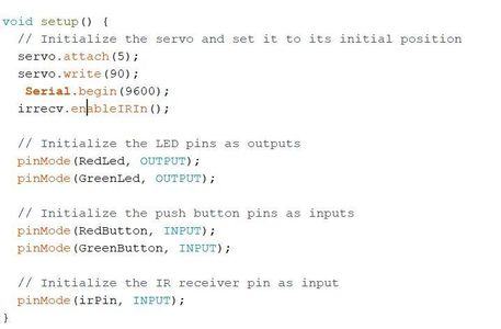

The void setup() function in Arduino is where you set things up before your program starts running. It runs once at the beginning and prepares everything for the main part of your code.
Servo Initialization:
It sets up the servo motor by attaching it to pin 5 using servo.attach(5).
It positions the servo at 90 degrees using servo.write(90). This is the initial position.
LED Initialization:
It prepares the LED pins (RedLed and GreenLed) to work as outputs, which means they can turn on and off.
Button Initialization:
It configures the button pins (RedButton and GreenButton) to work as inputs, so you can read their state (pressed or not pressed).
IR Receiver Initialization:
It sets up the IR receiver pin (irPin) as an input, allowing it to receive infrared signals.
By performing these setup tasks in void setup(), you ensure that the servo, LEDs, buttons, and IR receiver are ready to be used in the main part of your code.

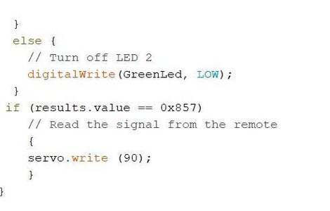

The first two if statements check the state of the RedButton and GreenButton. If the RedButton is pressed (its digitalRead is HIGH), it turns on the RedLed and moves the servo to position 180. If the GreenButton is pressed, it turns on the GreenLed and moves the servo to position 180. If neither button is pressed, the corresponding LED is turned off.
IR Receiver:
The code checks if there is an incoming IR signal by calling irrecv.decode(&results). If a signal is received, it further checks if the value matches code1 (in this case, 857). If the received signal matches, it moves the servo to position 90. After processing the IR signal, the irrecv.resume() function is called to enable the receiver for the next signal.
Continuous Execution:
The void loop() function runs continuously in an infinite loop. It keeps checking the button states, IR signals, and performs the corresponding actions based on the conditions. It does this repeatedly, allowing for real-time responsiveness to user inputs or external events.
