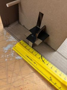

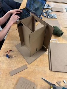

Step 3: Process Prototyping
We first created a cardboard prototype to test how the object would be able to slide down the platform, confirming measurements.
