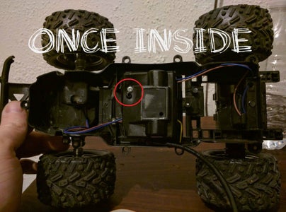

There are only a couple screws holding the plastic body on the frame (3 to be exact). Once you have those removed, there is one screw holding down the mainboard (beneath a protective plastic cover)--remove this also.
Step 3: Once Inside...

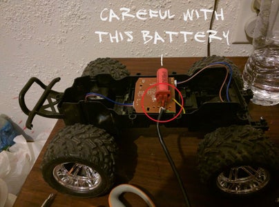

Warning: Lithium batteries do not like to be jostled around, nor will they tolerate being short circuited.
Caution: This step requires using a hot soldering iron.

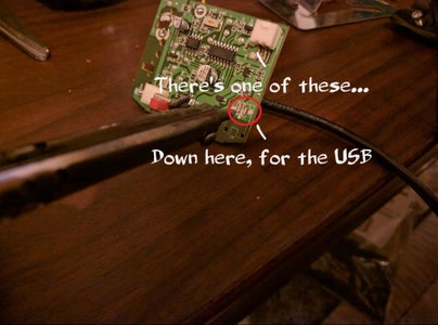

After the protective cover of the main board is removed, you will see a red battery cell. You will want to disconnect the three white clips with wires. Be gentle with them as they are not made of a durable plastic and the wires may pull out of the plastic connecter if you use too much force.

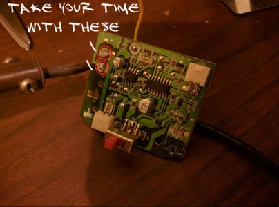

Next, pull the mainboard out and gently grasp the battery cell and make the green side of the board face you (as shown in the picture).
You need to apply gentle pressure to the battery (as if you are trying to pull it off of the board). Then heat up the solder on each lead of the battery. You can ask someone to help you with this part or just use your fingers to brace against the mainboard as if you're trying to pinch/push the battery away from the board.
Then, alternate heating up the solder on the battery leads. You may notice that as you heat up the solder, that the lead will kind of give a little, but only so far--because of the other lead being soldered in place. Take your time and alternate to the other lead, allowing the opposite lead to come out a little.
Continue being patient and repeat as necessary, until the battery is free.
Caution: Lithium batteries don't like high temperatures. If the hand that is holding the battery feels warm or uncomfortable then take a break!
Do not overheat the battery nor be in a rush. Especially if you want to preserve these tiny, rechargeable battery cells for another project.
Note: In the third picture you notice I am pointing at the mainboard and it looks as though something was removed. You are observant! On this board I removed the white plastic coupler because I wanted to use it (which did not work out in the end).
Step 4: The USB Cable

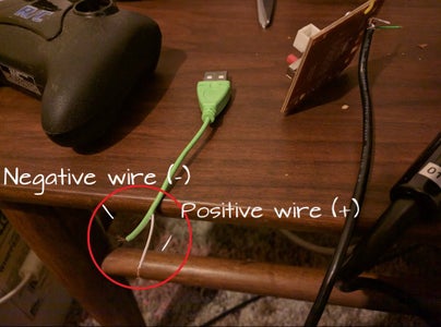

The USB cable you disconnected earlier has a long wire. Once you cut the protective covering you will notice two inner wires. One wire has a plastic shield on it (this is the + lead) and the other has no protective plastic shell (this is the - lead). This presented a problem for me...
Initially I used superglue to ensure that the + and - had no chance of touching each other, but when my nephew mishandled my R/C car and my + lead came loose, I ended up splitting open the white plastic and potentially exposing the wires to a short circuit (since the white plastic stuck to the super glue).
This could have been avoided if I had soldered properly the first time, but I had been experimenting (not shown nor discussed).
So, as long as you feel sure that the + and - leads are not going to cause a short circuit, the included USB wire works great for this project (it is still installed on my other R/C car).
You need to peel back the green plastic, to separate the + and - leads and allow working room for your fingers for the next step. For me, it took a little extra time, but gently putting the bare wire back inside of the green plastic sleeve and then supergluing the split in the sleeve was safe on both vehicles I had performed this 'operation' on.

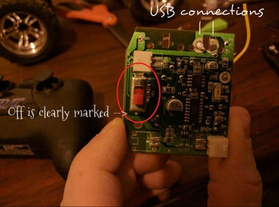

If you are using the USB cable that came with the R/C car, then + is white and - is the bare wire. If you are using your own USB, then power is red (+) and black (-).
You can see in the picture that + and - are clearly marked. If you have any doubts you are doing it correctly, please ask an adult for help. This may only be 3v-5v ~1A DC, but again, Lithium batteries are volatile and will catch on fire if short circuited (i.e. if the connection is improperly soldered etc.). Lithium is a metal and putting out a metal fire is not fun...trust me, I was in the Navy on a Submarine and we had to deal with metal fires.
Note: Before proceeding to step 7, I suggest ensuring the power switch is off now (otherwise when you connect the battery it will send live voltage through the mainboard before you're ready).
Step 6: Reinstall the Mainboard and Cover
Reconnect the wires taken off earlier.
Note: I shouldn't need to say it, but I want to ensure that it's understood that the USB does not get reconnected to it's original power socket. Only the front connector and rear motor are connected back.
The picture shows that there is a hole on the mainboard that should line up with the screw hole on the R/C car frame (circled area).

If you haven't already checked that the power switch is off, do so now.
Once you are ready, connect the battery and power it on.
