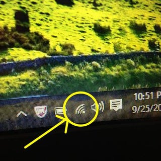

First, you will need to find the icon for the wireless interface on the laptop. Usually, it's located at the bottom right of the desktop screen. Below is a closeup of the wireless icon.
You will need to Right-Click on this icon - doing so will give you two choices: then left-click (normal click) on the "Open Network and Sharing Center" Line. If you can't find your wireless icon - then click on the bottom left of the screen where "Search Windows" box is and type in "Network and Sharing Center" - give it a few seconds and it will come up - now click on that to go to the Network and Sharing Center.
