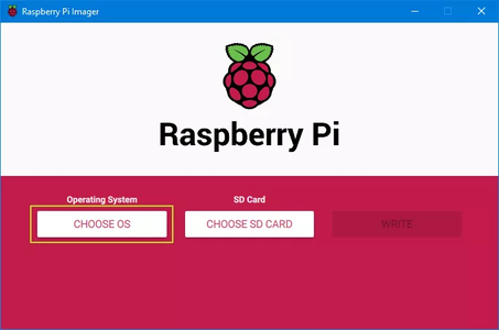

- Insert a microSD card / reader into your computer.
- Download and install the official Raspberry Pi Imager.

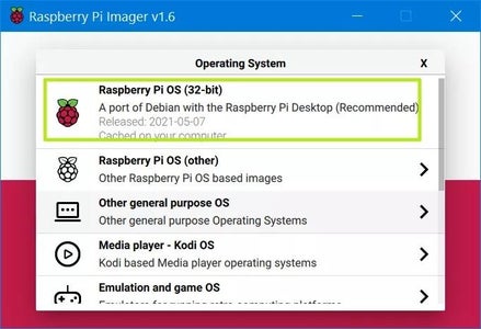

- Click Choose OS and select Raspberry Pi OS
- Click Choose SD card and pick the one you’re using.

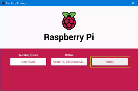

- Click Write.
The app will now take a few minutes to download the OS and write to your card.

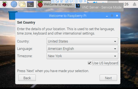

- Click Next on the dialog box and then select your country, language and keyboard type.

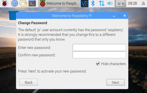

- Change your default password on the next screen or leave it blank for it to remain as "raspberry."

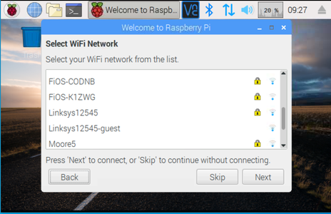

- Select the appropriate Wi-Fi network on the screen after, provided that you are connecting via Wi-Fi. If you don't have Wi-Fi or use Ethernet, you can also skip this.

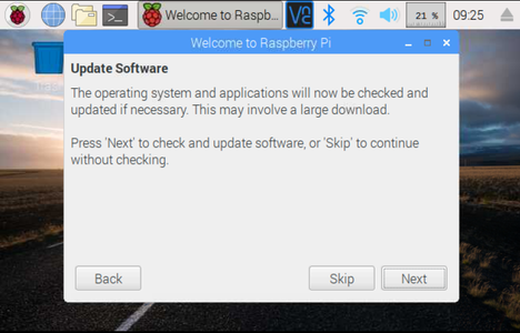

- Click Next when prompted to Update Software. This will only work when you are connected to the Internet, and it can take several minutes. If you are not connected to the Internet, click Skip.

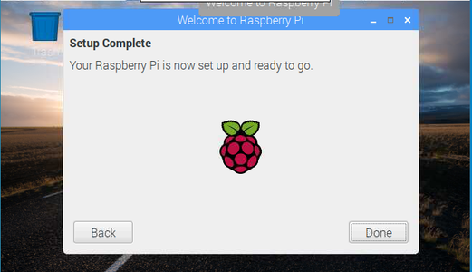

- Click Done or Reboot (if prompted to reboot).

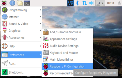

- you can configure the OS later. when you do go to preference Raspberry pi config.

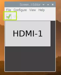

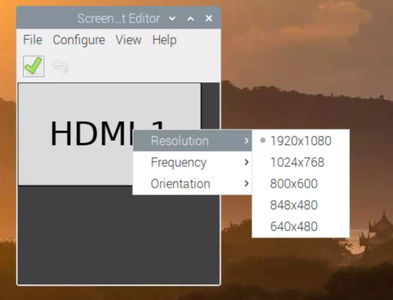

- Open the Screen configuration menu by clicking on the Pi icon then selecting Preferences -> Screen Configuration.
- Right Click on the HDMI box and select your Resolution from the Resolution menu.
- Click the Check box. The screen resolution will update.

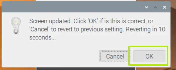

- Click ok if everything looks acceptable. If you don't, the screen will revert to its prior resolution.
