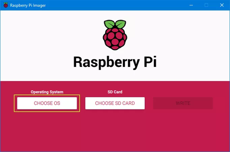

- Download and install the official Raspberry Pi Imager.

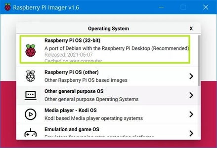

- Click Choose OS and select Raspberry Pi OS

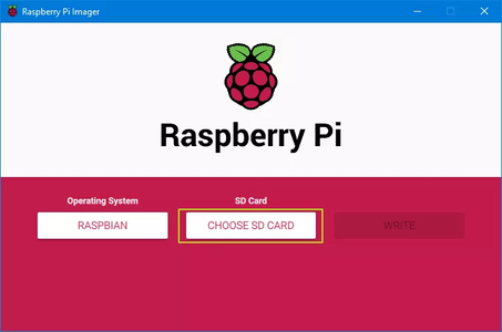

- Click Choose SD card and pick the one you’re using.

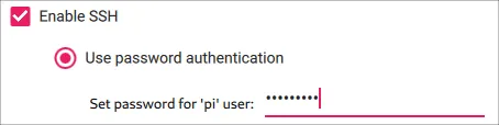

- The default password for the pi user is normally raspberry. You can change it to something harder to crack right away.
- Do not forget to Enable SSH.

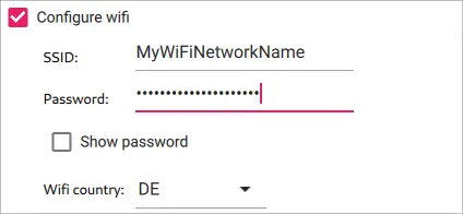

- If you plan on connecting your Raspberry PI to your local network via WiFi, then check the box for Configure wifi.
- Enter your WiFi network name in the SSID box and specify the password to gain access.
- Finally, select your country from the WiFi country drop-down selection box.

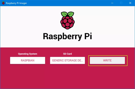

- Click Write.
The app will now take a few minutes to download the OS and write to your card.

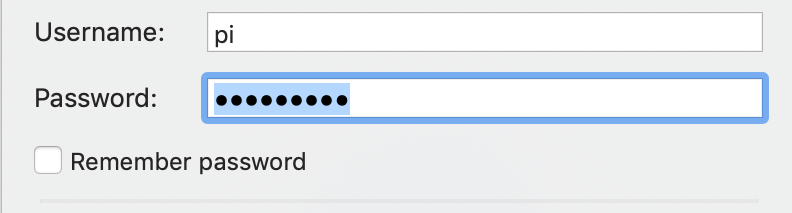

- Type in the the password and press [Enter].
- You maybe prompted to save the password in the Session Settings. This makes it quicker to connect next time but it is up to you.
