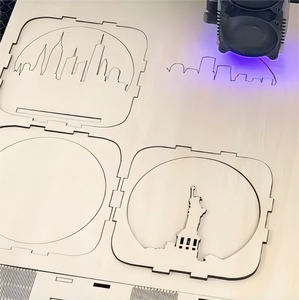

Step 2: Laser Cutting
Your machine should be large enough for laser engrave and cut a 30*45cm plywood sheet. Otherwise, you may need to adjust your file. I used NEJE MAX 4 v2(700*460mm). Once you adjust your settings, you can start cutting.

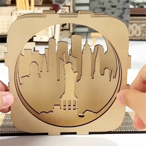

Step 3: Assembly

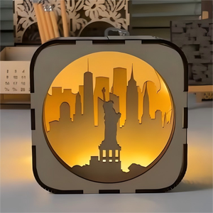

After the production is completed, assemble it layer by layer according to the order of the picture. Because the thickness of the wood can vary slightly, you may need glue to secure it. This lamp can be completed by inserting the led light string or small lights through the hole on the third and fourth layer.

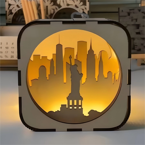

Step 4: Enjoy Your Work
Enjoy your lamp!
