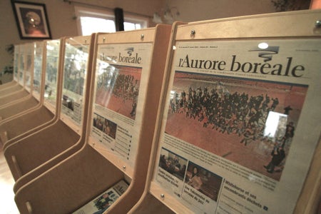

Based on this list, I designed a 4.5 feet tall stand in 1/2" Baltic birch plywood with acrylic panels on 3 sides. While this is not a common thing to build, I though I would share my design with the community in case somebody was looking for something similar.

On the pictures above, you will see the each part individually. Some of them have 1/4" holes on them. This is where you will put the dowels that hold everything together. Similar holes are drilled on the side of other boards.

The newspaper stands in between two 1/8" strips of plywood. In order to keep it in place, I added a 1/8" plexiglass panel against it. The acrylic can easily be removed by sliding it out of the 4 screws holding it.

There is a lot of space on the sides that can be used for advertising. We don't want to directly put stickers on the stand so we'll make sliding pockets with plexiglass panels.
In order to be able to slide a poster, the panel needs to be about 1/8" away from the plywood surface. To achieve that, we use small strips of plywood that we glue directly onto the sides and the front of the stand. The plexiglass is drilled in a few places and screwed onto these strips.
The 2" hole seen in the pictures is a to help you remove the poster once you slid it in those pockets. Just push the poster up from the inside with your finger.

To full fill the requirements, I added a slot that serves as a suggestion box. I also made a wooden box (the thing that says "Pick one up") to raise the stack of newspaper when they don't print as many as usual.
Step 8: Add Newspapers
You can now add your stack of newspaper. Without the removable wooden box, you can place around 400 copies.
The advertising posters need to be printed a bit smaller than the opening so that they can slide easily up and down. The front poster has a convenient size of 8.5"x11" (letter size).
