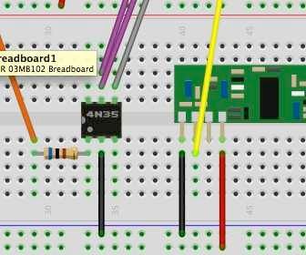

Step 1: The Circuit...
Wire the diverse components as shown in the picture.
Arduino pin#8 to Data pin on RX (receiver) module
Arduino pin#2 to Data pin on RX (receiver) module
Arduino pin#7 to Data pin on TX (sender) module
Arduino pin A0 to LDR
RTC configuration. Only needed on the External Server configuration.
Arduino pin A4 to SDA pin on RTC module
Arduino pin A5 to SCL pin on RTC module
