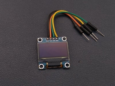

Let’s start by assembling the display. First, I soldered four color-coded wires to the 0.96" OLED display to make the connections simple and organized:
  1. 🔴 Red – VCC (Power)
  2. ⚫ Black – GND (Ground)
  3. 🟢 Green – SCK (Clock)
  4. 🟡 Yellow – SDA (Data)
Once the wires were securely soldered, I fixed the display inside the enclosure. I initially used a hot glue gun, but I don’t recommend it for long-term use — it can get messy and may not hold well over time. Instead, I suggest using B-7000 glue for a cleaner and stronger bond.

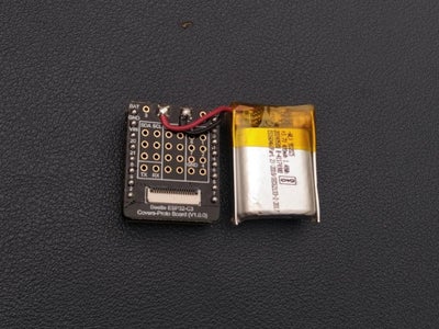

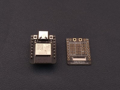

Step 3: Battery Connection

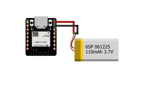

Since DFRobot Beetle ESP32-C3 microcontroller includes an integrated battery charging circuit, there's no need for an external charging module.

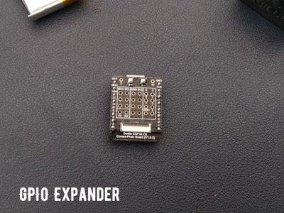

To set up the battery, I used the GPIO expander board that comes bundled with the Beetle ESP32-C6. It makes accessing the battery connection points much easier. I soldered the battery’s negative wire to the B– (Battery Negative) pad and the positive wire to the B+ (Battery Positive) pad. Check The Provided Circuit Diagram for better understanding.
I'm using a 3.7V Lipo battery for this project. Make sure to double-check the polarity before soldering, as reversing the connections could damage the board.

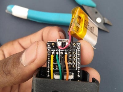

Step 4: Display Connection
Connecting the display to the microcontroller is super simple. On the GPIO expander board that comes with the Beetle ESP32-C6, you’ll find clearly labeled pads for 3.3V, GND, SCL, and SDA. These are exactly what you need to hook up the OLED display. Check the provided circuit Diagram for better understanding.
  1. Display VCC to 3.3v of GPIO Expander
  2. Display GND to GND of GPIO Expander
  3. Display SCK to SCL of GPIO Expander
  4. Display SDA to SDA of GPIO Expander
That’s it — the wiring is complete and ready to go. Make sure the connections are firm and the wires are not too long to avoid signal interference.

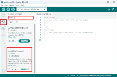

Step 5: Arduino IDE Setup
Install Arduino IDE
If you do not already have it, download and install Arduino IDE 2.0 latest Version from official website of Arduino.

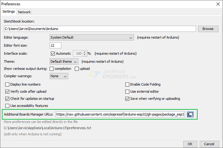

Add the ESP32-C3 Board Support URL
  1. Open Arduino IDE.
  2. Go to File > Preferences.
  3. In the Additional Board Manager URLs field, paste the following URL:
https://espressif.github.io/arduino-esp32/package_esp32_index.json
  1. Click OK to save your changes.

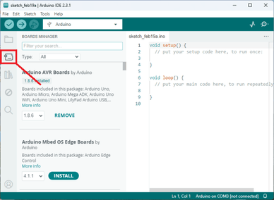

Install the ESP32 Board.
  1. Go to Tools > Board > Boards Manager.
  2. In the search bar, type ESP32.
  3. Click & Install the latest version of ESP32
Verify Board Installation
  1. Once installed, DFRobot Bettle ESP32-C3 should now appear under Tools > Board.
  2. Select DFRobot Bettle ESP32-C3 from the list to start programming the device.

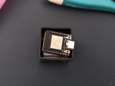

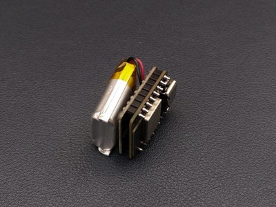

Step 7: Microcontroller & Battery Assembly
Now it’s time to place the microcontroller and battery into the enclosure. Carefully position the Beetle ESP32-C6 so that its USB Type-C charging port aligns perfectly with the dedicated cutout in the case. This ensures you can easily charge the clock.
Once aligned, place the battery inside the case next to or beneath the board, depending on your internal layout. To secure everything in place, apply a small amount of B-7000 super glue — just enough to hold the components firmly without creating a mess & Let the glue dry completely before moving to the next step.

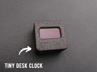

Step 8: Final Assembly

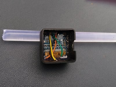

With all components securely in place, it’s time to complete the build. Gently close the enclosure using the 3D-printed top cover, making sure everything fits snugly without putting pressure on the wires or display. To finish the assembly neatly, apply a small amount of B-7000 glue along the edges of the cover. This will hold it firmly in place.
Step 9: Testing
Now it's time to test. Once it got connected with Wi-Fi network, it will automatically fetch the current date and time from an NTP (Network Time Protocol) server. The date will appear at the top of the screen in the format DD/MM/YYYY, and the time will be shown below in 12-hour format as HH:MM along with AM/PM.
